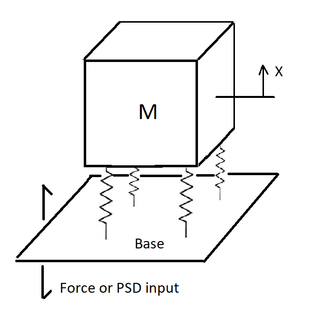

The system is a 4 springs and 1 mass on a vibrating base, the system has a low natural frequencies (the mode shapes are: 4, 4.2, 5, 5.5, 8, 11, 11.2 Hz). When excited with a random vibration like in the attached PSD curve below.

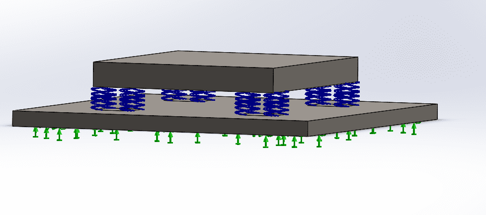

Please find the following model and other information for the problem above:

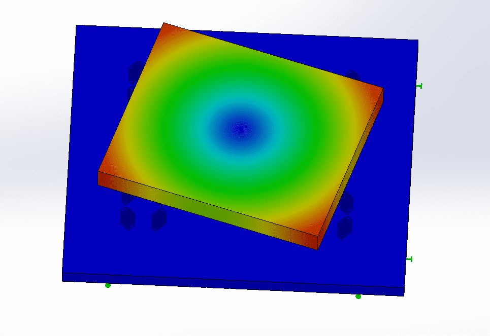

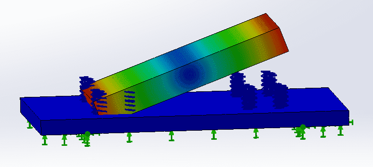

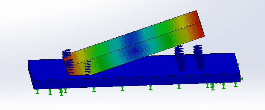

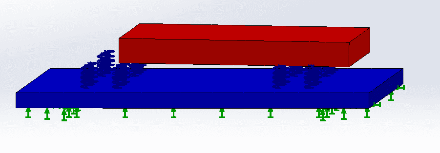

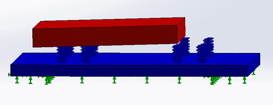

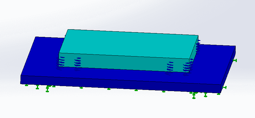

Mode shapes (pics02-07 are the modes 1-6 respectively):
Mass : 19 KG , identical springs with coefficient: 12 kN/m tension/compression (48 kN/m for the 4 springs) and 3.9 kN/m in shear (15.6 kN/m for the 4 springs), damping ratio: 0.2 , box size: 300x250x300 mm (the height is 300 mm, but it is incorrectly simulated as less, but that won't affect the frequencies of the whole box).

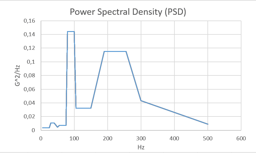

When the PSD curve is integrated it result in the root mean square of the input accelerations (Grms), and the Grms here is 25G.
These are some points from the PSD curve above:
Freq (Hz)525304050557580100105150190255300500
PSD (G^2/Hz)0.003590.003590.01080.01080.004670.00720.00720.144120.144120.032420.032420.11530.11530.043230.009
This is not a schoolwork but a project I am working on, the product is supposed to be military tested (810F standard) and this is one of the random vibrations it will be subjected to.
I am interested in the acceleration levels that will be transferred to the product (force amplification), and since the resonant frequencies are very close together, how will that affect the resulted force amplification ? In other words how can I consider the coupling of all the frequencies to the force amplification ?

Dr.D said:
Looks like you gave mode frequencies, not mode shapes, We really need a picture and some coordinates to talk about hat this will do. Is this a seismic excitation?
The product is supposed to be military tested (810F standard) and this is one of the random vibrations it will be subjected to.

Since you already have finite element model in SolidWorks Simulation (I recognize it from the pictures) you can also perform random vibration analysis in this software. Just apply acceleration from curve and solve to get desired results.
I think you are mistaken about this not mattering. By using the incorrect height, the pitch and roll moments of inertia will be incorrect. This will affect the eigenvectors and the eigenvalues.
Again you're absolutely correct, that was very foolish of me to assume otherwise, thank you for pointing it out !
I am doing a more realistic simulation now and will upload the results soon.
