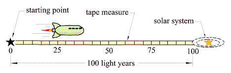

How would the solar system appear if you approached at near c?
The discussion revolves around the relativistic effects experienced when approaching the solar system at velocities near the speed of light (c). Participants explore concepts from special relativity (SR), including time dilation, length contraction, and the implications for observing Earth's orbit from such a frame of reference. The conversation includes theoretical scenarios and challenges related to the interpretation of these relativistic effects.
  • Some participants propose that approaching Earth at near-c would result in significant length contraction, suggesting that distances would appear foreshortened to a Planck length.
  • Others argue that time dilation is not directional, asserting that if Earth's clock appears slow, it does not imply that Earth is moving quickly in any direction relative to the sun.
  • There is a contention regarding the interpretation of time passing on Earth versus the traveler's experience, with some suggesting that a century on Earth corresponds to a Planck time for the traveler.
  • Some participants challenge the notion of a theoretical maximum speed, stating that one can always accelerate closer to c, while others emphasize that the maximum speed is not c but rather anything less.
  • One participant questions the use of specific numbers in examples, suggesting that simpler values would facilitate discussion.
  • Another participant notes that the scenario's specifications regarding time and distance must be clearly defined within a specific reference frame to avoid confusion.
  • There are conflicting interpretations about whether Earth's clocks would appear to run faster or slower from the traveler's perspective, leading to further clarification attempts.
Participants express multiple competing views on the effects of relativistic travel on time and distance measurements. The discussion remains unresolved, with no consensus on the implications of approaching the solar system at near-c speeds.
Limitations include the need for clear definitions of reference frames when discussing time and distance, as well as the complexities introduced by relativistic effects that may not be fully addressed in the conversation.

  • #33
Chris Miller said:
But not the distance between Earth and my ship?
In the stationary frame, where ship was initially 100 lights away from Earth? No, by definition of this frame. If we place an asteroid, or whatever, at this origin point, then we will have an "asteroid-Earth" object, that is 100 light years long and is at rest in the stationary frame. This object is 1 Planck length long and is moving towards the ship in the near-c frame. Likewise, the ship has normal rest length in the near-c frame and almost zero length in the stationary frame. Seems reciprocal enough.
Chris Miller said:
I know I'm failing to grasp some essential concept here, and just keep re-expressing this non-understanding.
You can just keep hitting the wall with your head, hoping that understanding will somehow just fall onto your head, or you can try and work through a textbook. Special relativity is not too complicated a theory, but it has its subtleties, and if you want to get it, you just have to put in some serious, systematic effort. You have to learn to use and understand space-time diagrams and Lorentz transformation formulas - these are the essential concepts, that you're missing here. All the special effects (time dilation, length contraction, relative simultaneity, etc..) are derived from them.
Chris Miller said:
But can't find/imagine/describe a point in my ~c frame that precedes Earth's 100 solar revolutions.
An inertial near-c frame wouldn't be inertial if it didn't exist forever, so to speak. There should be enough past in it to contain all the Earth's revolutions that have ever happened.

  • #38
Mister T said:
Suppose the first of those revolutions occurs during the year 1901 and the 100th during the year 2000. What do you find/imagine/describe happened during the year, say, 1865?
Among other things, Earth revolved about the sun one time.
Yes, of course. And so during my ~c ship's t = -n nanosecond, the Earth orbited the sun 100 times?
  • #39
Battlemage! said:
If the bold is your main question, I think someone pointed out that an orbit can be considered a clock, and if you're at rest in the spaceship then it appears to me that the Earth's orbit would constitute a "moving clock" according to your reference frame. Yes, no? Maybe so?
Apparently, from my ~c spaceship the earth/clock would appear almost frozen in its orbit, just as my on board clocks would to Earth observers.
