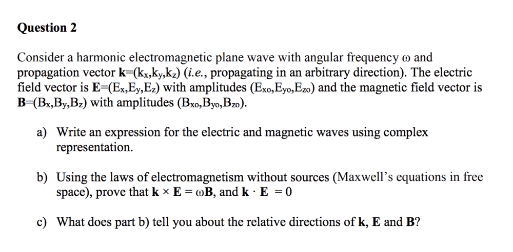

Part a is not an issue, I have that solved. I'm confused with part b (and c since i cant get b), and need someone to explain this to me... I do not even know where to start. Although, I do know that k E and B are orthogonal to one another. Evidently, this means that the dot product between k and E will be 0, as they are perpendicular. I just don't know how to use Maxwells Equations to prove this.
Thanks!
Maxwells Equation
The two Maxwell's equations you going to use for this are
1) Gauss's law in differential form $$\nabla\cdot E=0$$ (with no sources)
2)Maxwell-Faraday's law in differential form $$\nabla\times E=-\frac{\partial B}{\partial t}$$
Start by pluging in 1) the expression for electric field you got from doing part a) and try to calculate ##\nabla\cdot E##. You might find the following identity useful ##\nabla\cdot( \phi E_0)=E_0\cdot\nabla\phi## where ##\phi(x,y,z,t)## is a scalar function and ##E_0## is a constant vector independent of x,y,z,t.
When plugging the expression you got from a) for E in 2) you might find useful the following identity
##\nabla\times (\phi E_0)=\nabla\phi\times E_0##
