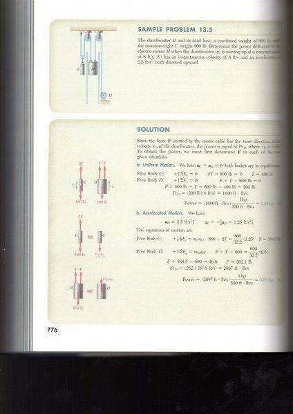

Hi!
I am new to this forum and i have problem understanding sample problem 13.5 from Vector Mechanics for Engineers 10th edition Statics and dynamics. (Beer)
In particular I don't understant how in part b assigns the value aC=-1/2aD
If anyone can help
thanks
on Phys.org
We don't have every possible technical book immediately available for reference - please tell us yourself what the actual problem is .
I have scanned the page with the sample problem and i attached it
