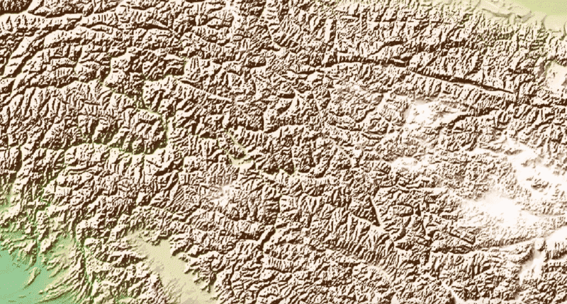

The Himalayas ^^^ are not that high, it's I who is very small. Folding cause just a bit in increase of height, it is just that 8km is too much for me. The above image really explains folding than a whole book on it.

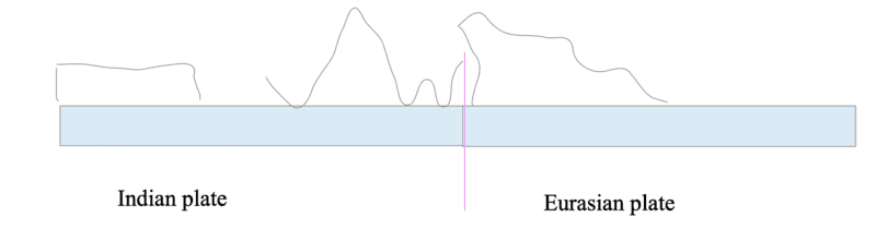

Next doubt: Are Himalayas on Indian plate or Eurasian plate? Are these two plates touching each other only on the crust or some high landforms on Eurasian plate is also touching something on Indian plate?

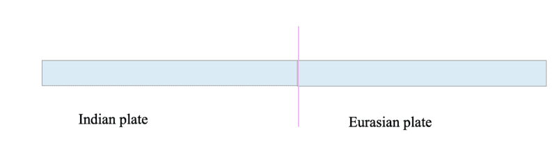

The doubt has quite its merit, because plates are not simply like this:
they have things on top of them, maybe like this
What I have read is that the Indian plate has to some extent not simply subducted down when it ran into the Eurasian plate, but kind of slid under it, making a double thick layer of crust in some areas.
For reasons unknown to me.
