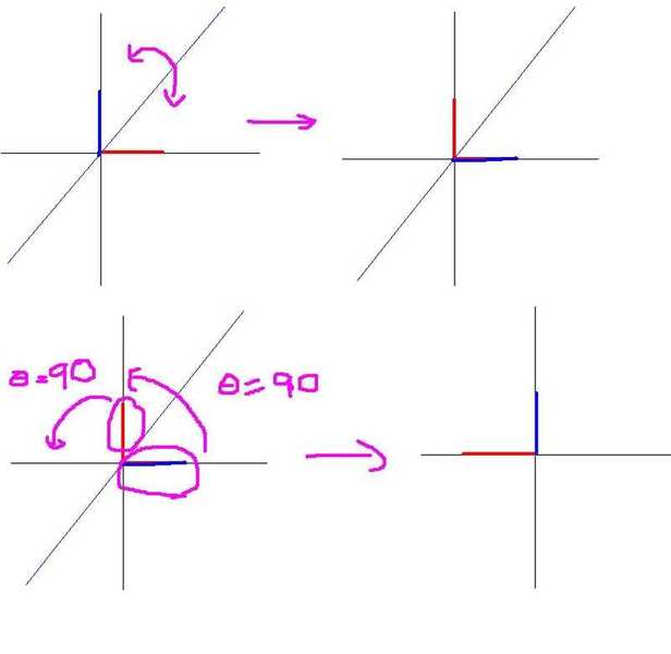

Now the way I did it is that I drew a picture with my unit vectors and I just follow where my vectors go according to the instructions
I will even draw a picture for you
http://img703.imageshack.us/img703/6665/unledhg.th.png
Uploaded with ImageShack.us
So at the end, my vectors ended up as [tex]\begin{bmatrix}<br /> -1 & 0 \\ <br /> 0 & 1<br /> \end{bmatrix}[/tex]
Now my question is, who is right?

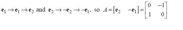

Does that mean I am wrong? Because my textbook does the following and I tried multiplying matrices like you did, but it isn't right.
[tex]T: \mathbb{R}^2 \mapsto \mathbb{R}^2[/tex] first reflects points through the horizontal x1 axis and then reflects points through the line x2 = x1
My book has the matrix [tex]\begin{bmatrix}<br /> 0 & -1\\ <br /> 1 & 0<br /> \end{bmatrix}[/tex] as the answerNow I also got that as my answer using the matrix transformation or drawing the pictures.
If I were to multiply the two transmations like you did
[tex]\begin{bmatrix}1 & 0\\ 0 & -1\end{bmatrix} \begin{bmatrix} 0 & 1 \\ 1 & 0 \end{bmatrix} = \begin{bmatrix} 0 & 1 \\ -1 & 0 \end{bmatrix}[/tex]
Which is wrong.
Now in my textbook, they do transformations like this
Now going back my original question, I did it both ways, I did it the way my textbook did and the way I usually do it (with pictures). So why do they give me different answers?

Yes. That is wrong because you are multiplying them the wrong way. When you take matrices A and B multiply Bx first then multiply by A you get ABx. In matrix multiplication, the first one to operate is on the right. Multiply them in the other order.
I used wolframalpha http://www4a.wolframalpha.com/input/?i={{1%2C0}%2C{0%2C-1}}*{{0%2C1}%2C{1%2C0}}
Also, can you tell me what the book is doing?
Also, going back to my very original question, the one where my intuition was right but my textbook method was wrong, why?
Your textbook method is correct and you get the same answers with matrices if you multiply them in the correct order. If you are still having problems and you want me to continue this discussion with you, post a specific example you have worked both ways in your next post. Don't refer to older posts or links.
No the original problem is the problem where I worked both ways and I arrived with different answers. Check post #8 of this thread

There are errors in both of these. I'm assuming that the transformations are 1)reflect across the line y = x, and then 2) rotate by 90 deg. CCW, in that order. This is what you had in your first post.
In the first line above, e1 --> e2, but then e2 --> -e1.
In the second line above, e2 --> e1, and then e1 --> e2. As a result of both transformations, the vectors {e1, e2} become {-e1, e2}
The matrix that represents the composition of both transformations is
[tex]\begin{bmatrix} -1&0\\0&1\end{bmatrix}[/tex]
Notice that this is the same as when you carry out this multiplication
[tex]\begin{bmatrix} 0&-1\\1&0\end{bmatrix}\begin{bmatrix} 0&1\\1&0\end{bmatrix} [/tex]
The second matrix in the product above is the reflection across the line y = x. The first matrix in the product is the rotation.
