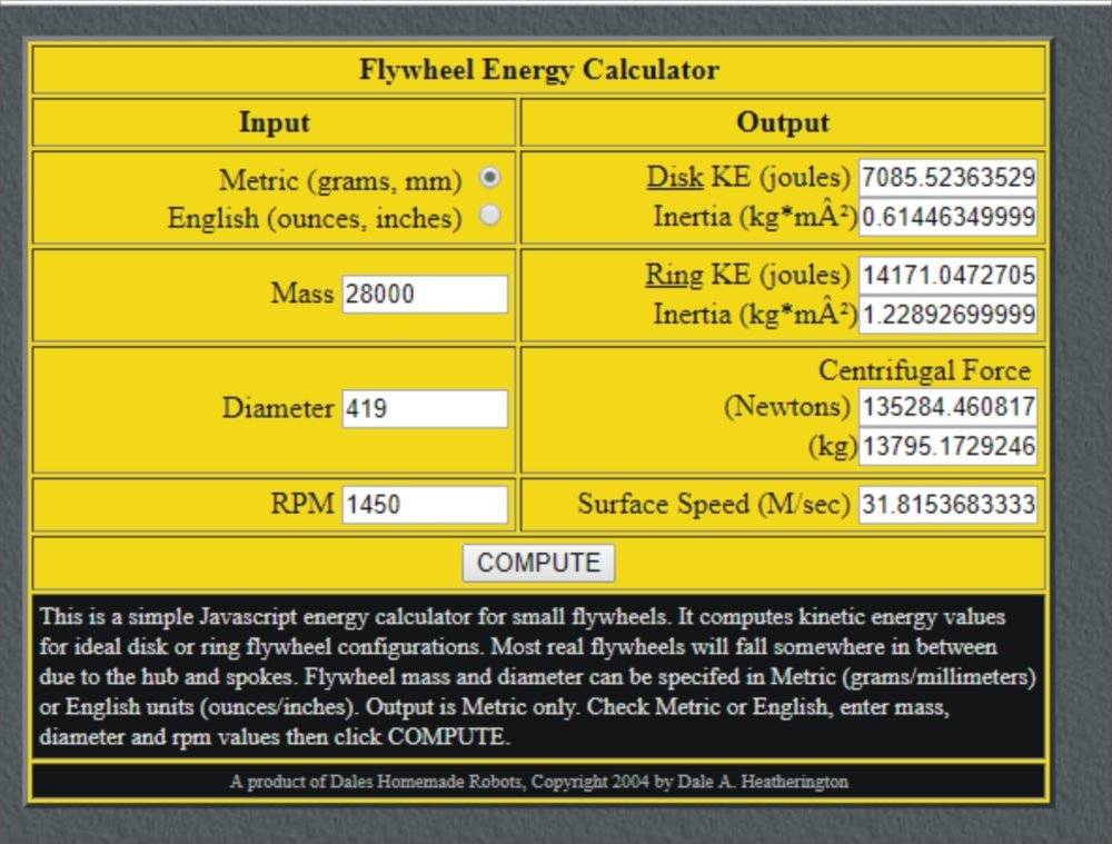

mohammad irshad
hi sir
i have 1100 watt motor and i want to rotat the fly wheel from rest to 1450 rpm.i want to know how big should be
the flywheel to rotate at the motor 1100 watt and to get extra energy 700 joule or more than if possiable
best regard
thnx
I'm not sure I understand what you are looking for, but doesn't that flywheel calculator tell you how big/heavy the flywheel needs to be to store 700J?
Also, just to be clear: power is energy per unit time. Flywheels store energy and how long it takes to dissipate that energy determines the power.
