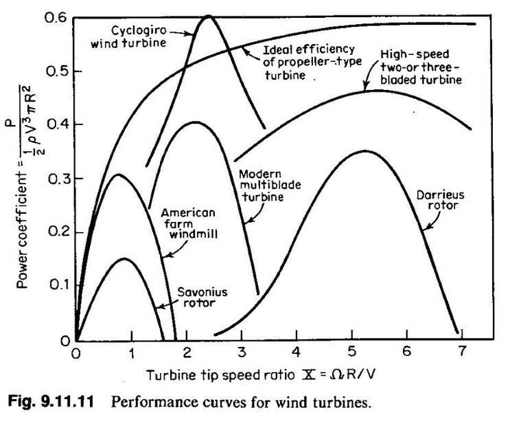

And here is a plot that shows why he said that:
It's from Marks' Standard Handbook for Mechanical Engineers, Ninth Edition. Compare the weight and complexity of a Savonius rotor to a standard two blade turbine with the same wind catching area.

Baluncore said:
In this case the ability to place the turbine blade horizontally and be able to elongate it for more blade surface area if needed seemed like a good option because of the small space in which it will operate. A traditional prop style blade doesn't fit the space available very well, but it sounds like the recomendation from everyone here is to find a way to make that work. Message received. Thank you for the feedback.
If you are working with one of those cheap little hobbyist DC motors, be aware that they have cheap plain bearings and cheap brushes, so a lot of friction. You can measure the starting torque of the motor by wrapping a string around the shaft and measuring the force to turn the shaft by pulling the string. Your wind turbine needs that much torque just to get the generator to start moving.
Thank you @jrmichler for that diagram. That really helped me to "get it".
While, qualitatively, I agree with this plot in that the Savonius is a pretty useless design unless the goal is absolute maximum simplicity with minimal concern for actual power collected, this plot was clearly done by someone who has no idea whatsoever about the operating conditions of wind turbines.
Modern multiblade wind turbines tend to operate at tip speed ratios around 8-10, which is well off the right side of this chart, and for this to show them falling off dramatically above 2 is so wrong as to be totally laughable. Honestly, you'd be hard pressed to find a single horizontal axis wind turbine designed in the last 3 or 4 decades that wouldn't be designed to operate at either the far right side of this chart or off the right side of this chart. I suppose you could try to claim that all modern designs fall under "high speed two or three bladed turbine", but even then, two blade designs likely are operating at 10+ TSR, and the falloff above 5 is totally incorrect, plus that brings into question what the point of the "modern multiblade turbine" curve even is, since nearly all modern turbines are a 3 blade horizontal axis design.
This really, really should be updated, or at least used with caution.

If the above plot comes from this book, I'm really not impressed. It contains some very serious errors.
I'd highly recommend something like the Wind Energy Handbook instead.
