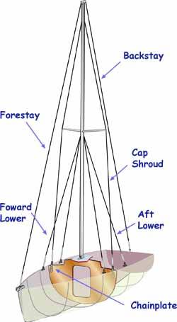

I ran out of pieces to brace the structure, so that is why it is unstable.
Adding more pieces is not the only way to brace things. Consider this drawing of a sailboat.
Nor is the method of bracing the only interesting question. How is the ball's motion different with a braced or not-braced structure? Does the ball reach the bottom faster or slower?
You could also treat it as a puzzle. Holding the number of K'NEX pieces constant, how to arrange them to make the stiffest structure? That is like an engineer trying to make the best design using a fixed budget.
