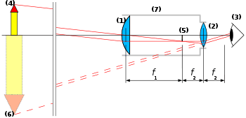

I want to make an astronomical telescope, can anybody help. I need specifications for the lenses.

You can build a keplerian telescope with any two convex (magnifying) lenses
You can easily measure the focal lengths with just the sun and a ruler so any two random lenses will work.

Magnification of 60x means the exit pupil is 1/60 diameter of the input aperture.
If your dark adapted pupil is 5mm then you need the input to be 300mm (5mm*60)

Slightly less important, in my opinion, than radius of the primary is focal length. You can always change the magnification by using different secondary lenses. The magnification is the focal length of the primary divided by the focal length of the secondary. The longer the focal length of the primary, the larger the focal length of the secondary can be for a given magnification which makes it a little easier to focus.
