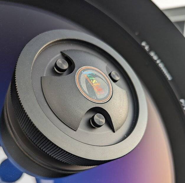

Front view of a Celestron EdgeHD 14 telescope showing the Schmidt corrector plate, the secondary mirror assembly with its central cylinder, and the blue-purple coated primary mirror beneath.
Figure 1. Front of the telescope with the collimation screws hidden behind the Fastar logo thingy that partially shields the screws from dew and whatnot.
Front view of a Celestron EdgeHD 14 telescope showing the Schmidt corrector plate with the StarBright XLT coating and the central secondary mirror assembly, with a small logo on its hub.
Figure 2. Fastar logo thingy twisted to expose the collimation screws. They are Phillips head screws.

Front view of a Celestron EdgeHD 14-inch Schmidt-Cassegrain telescope showing the corrector plate, with the secondary mirror assembly and its surrounding logo partly visible.
Figure 3. Collimation screws are now Bobs Knobs.

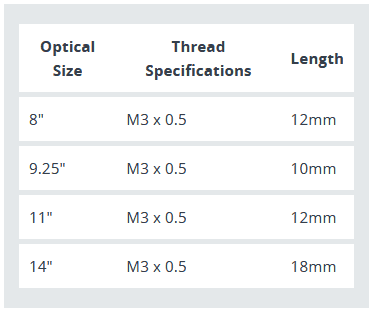

From anybody interested, here's the specs for Celestron's collimation screws (specifically for EdgeHD scopes, shown here):
Table 1. Collimation screw specs for EdgeHD optical tubes:
Table of Celestron EdgeHD collimation screw specifications with columns Optical Size, Thread Specifications and Length: 8 inch M3 x 0.5 12mm; 9.25 inch M3 x 0.5 10mm; 11 inch M3 x 0.5 12mm; 14 inch M3 x 0.5 18mm.
(Source: https://www.celestron.com/blogs/kno...on-current-production-celestron-optical-tubes)

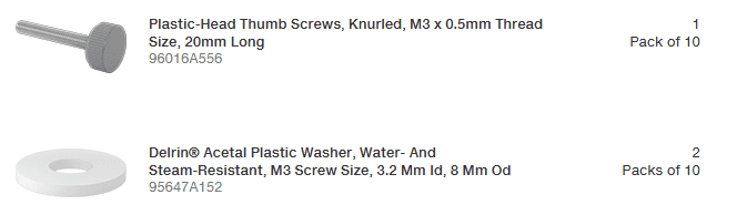

I've got the C14 Edge HD, so that means I need M3×0.5, with 18 mm length. I found the following parts from McMaster-Carr:
  • Plastic-Head Thumb Screws, Knurled, M3 x 0.5 mm Thread, 20 mm Long (Head color: Black)
  • Delrin® Acetal Plastic Washer, Water- and Steam-Resistant, M3 Screw Size, 3.2 mm ID, 8 mm OD (Thickness 0.7-0.9 mm)
McMaster-Carr order list showing black knurled plastic-head thumb screws, M3 x 0.5mm thread, 20mm long, quantity 1 pack of 10, and white Delrin acetal plastic washers, M3 screw size, 3.2mm ID, 8mm OD, quantity 2 packs of 10.
Figure 2. My McMaster-Carr order.

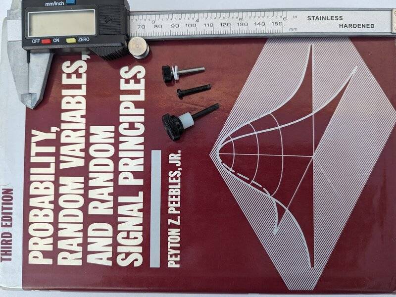

The washers are meant to reduce the shaft length from 20 mm to something closer to 18 mm. I figured two or three washers per screw should do the trick (I went with 2 in the end). I bought plenty of washers to be on the safe side.
While it's not clear from the image and description, the screw threads are chemical-resistant 18-8 stainless steel. (More on that later; boy, I hope that means they're also corrosion resistant.)

Now that I had one of the Bob's Knobs screws out for comparison, I photographed it on a random book alongside one of the original Phillips-head screws, and one of the screws from my new solution. See Figure 4.
Digital caliper measuring a black knurled thumb screw with a white washer, beside two other black screws, resting on the cover of Probability, Random Variables, and Random Signal Principles by Peyton Z. Peebles, Jr.
Figure 4. Collimation screw comparison. Screws were placed on some random book along with calipers for scale. Top screw is my new solution. Middle screw is one of the original Phillips-head screws. Bottom screw is one of Bob's Knobs.

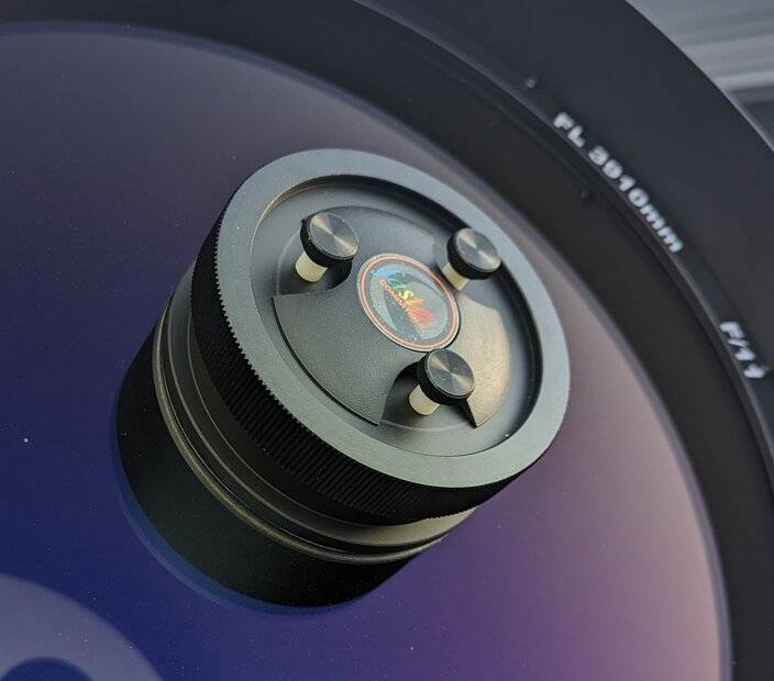

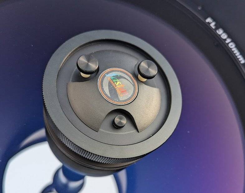

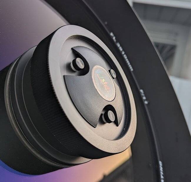

Close-up of a telescope's front cell showing three black knurled collimation screws with a round holographic Celestron-style label in the center, on a dark tube with an engraved scale.
Close-up of a telescope's collimation screw assembly with a black knurled knob, a circular dark plate with two thumb screws, and a small holographic label at the centre.

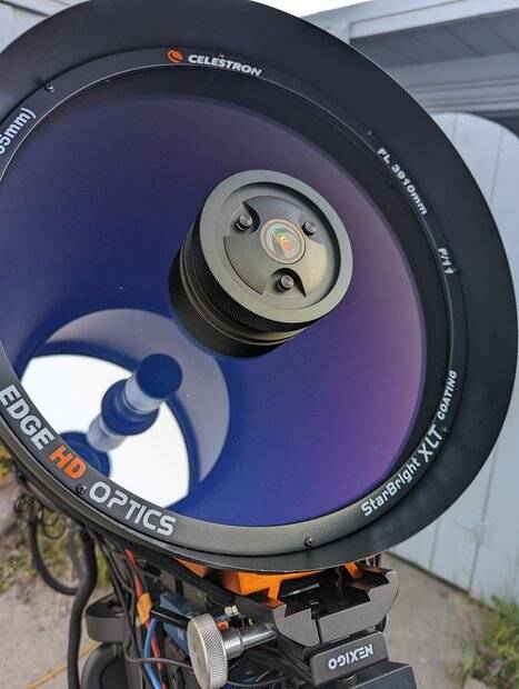

Front view of a Celestron EdgeHD 14 telescope tube showing the corrector plate with a blue-purple coating, a central secondary mirror holder with three collimation screws, and the Celestron StarBright XLT logo around the rim.
Figures 5-7. New screw solution installed.
Re-collimation went well. The new solution is almost as easy as it was with Bob's Knobs. But now there's no increased risk of Schmidt plate destruction/obliteration if I remove the OTA from the mount.
The only thing I worry about is corrosion. The original Phillips-head screws and the Bob's Knobs had threads of black oxide (or maybe black anodizing?). Where the screws in my solution are chemically resistant stainless steel.
Which is more resistant to corrosion? This isn't my area of expertise. Is switching to stainless an upgrade or a downgrade in this regard?
I've tried to look online for answers, and from what I can gather, I might be OK. But I haven't been able to find what I consider a definitive answer, and corrosion resistance isn't my field of expertise.
Besides the corrosion questions though, things look quite promising. :smile:
