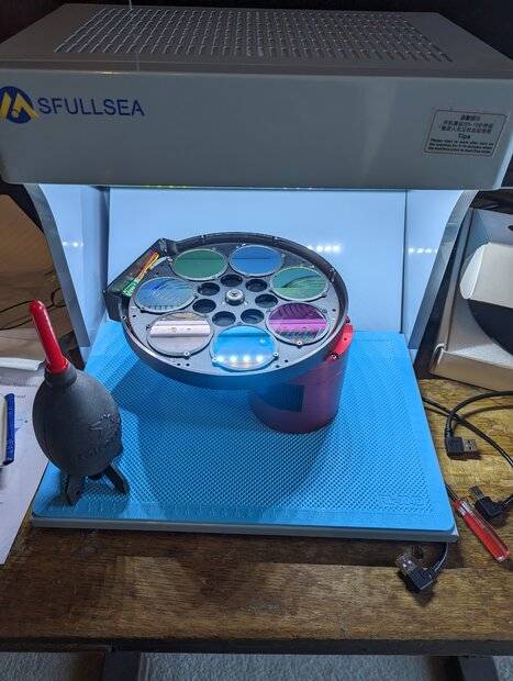

This thread is for documenting the setup of my new telescope.
It's not completely new, I'll be using some peripherals from the old telescope, such as the camera, filter wheel, off-axis guider (OAG), mini PC, focuser, etc. But the optical tube assembly (OTA), mount and tripod are new.
Also new are some filters, which is where we start today.
I'm replacing the old 2" Optolong filter set with new Antila, 3 nm, narrowband filters plus some Baader LRGB filters. Notable changes are:
  • New filters are 50.4 mm round, unmounted. The usable diameter is slightly larger than the 2", threaded filters, which should lead to a tad less vignetting with the camera's full frame sensor.
  • I'm no longer going to use a broadband light pollution filter for luminance (I was using the Optolong LPro filter). Instead, I'll be using a simple UV/IR cut filter. The light pollution filter made sense back when low pressure soduim lights were more commonly used in streetlights. But with the proliferation of LED lights, the justification for a light pollution filter is dwindling, Also, Optolong doesn't make a 50.4 mm round, unmounted package for their LPro filter anyway. I'll still use it in the smaller telescope setup for now, but no longer in the big telescope setup.
  • I've heard good things about the Antlia, 3 nm narrowband filters, so I'm looking forward to giving them a try.
  • The old, 2", threaded, Optolong narrowband filters have served me well, and I plan on eventually swapping them over to the smaller telescope setup (which uses the APS-C size sensor, and thus won't suffer for vingetting by these filters). You may have caught me complaining about the halos in the smaller telescope setup that presently uses Baader narrowband filters. The Optolong narrowband filters might be a tad bit better in this respect.

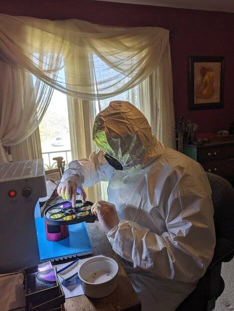

A person in a white protective suit and hood sits at a table, handling a round filter wheel holding several colored filters over a blue device.
Figure 1. Me getting started on filter replacement.
I've had it up to here with dust getting on filters and camera window. So I didn't mess around, and got a cheapy, laminar flow hood thing.
Getting dust on the telescope's objective or corrector plate isn't that big of a deal, but getting dust on the filters or camera window is a huge pain. Taking flat frames helps (and I'm a stickler for flat frames), but it doesn't always eliminate the effects of dust motes completely.
Unfortunately, I don't think these measures were enough. The flow out of the hood thing isn't all that laminar, and let's face it: my home is too intrinsically spooky to eliminate all the dust. It doesn't help that my favorite decorations are piles of dust and cobwebs.
Astrophotography filters and a red cooled camera on a blue mat under a light, with a filter wheel, a boxed Antlia filter and a screwdriver.
Figure 2. New filters now secured in place.
Photo of a filter wheel with a circular carousel holding round colored astronomy filters in a blue-grey housing, mounted on a blue mat beside a red-tipped rubber air blower bulb, with an SFULLSEA label on the housing.
Figure 3. Filter wheel is now screwed into the camera, and time to close 'er up.
More to come ...

jedishrfu said:
Considering the situation are the suit and mask a little bit overkill?
They're pretty standard clean-room attire. The bigger problem for me is the room itself.

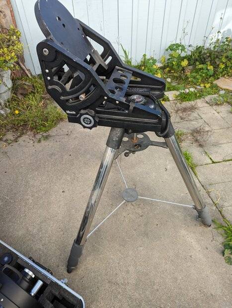

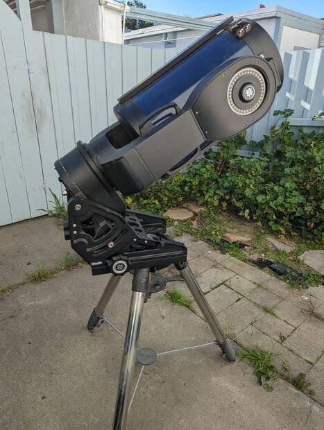

Before the new scope goes up for the first time, I must strip and tear down the old scope for the last time -- the last time for at least a little while anyway (not forever).
Photo of a telescope mounted on a tripod outdoors, with a finderscope, a green camera body, a black optical tube and several cables and a blue cable attached.
Figure 1. Here's an image with all the peripherals (except for the camera, OAG, and filter wheel which were already removed) and cables and such still attached.
Black Meade telescope with a Schmidt-Cassegrain style optical tube mounted on a fork-type German equatorial mount and tripod, standing outdoors on a patio in front of a fence.
Figure 2. All stripped down now.
Black Schmidt-Cassegrain style telescope tube on a computerized German equatorial mount, photographed outdoors against a light grey fence and gravel ground.
Figure 3. All stripped down, other side, plus a lens flare.

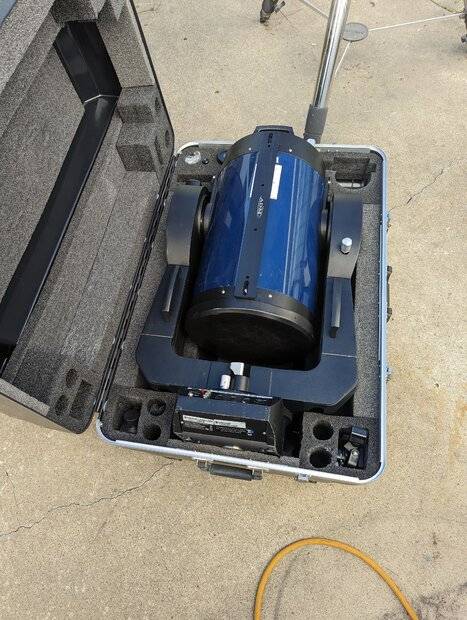

Blue telescope optical tube with black mounting rings sits in a foam-lined aluminum hard case, with a black accessory box and a small hand-held controller in the foreground.
Figure 4. Back in its JMI case. That took a bit of doing. I am out of shape. The next big step (in the future) for this scope is to open up that bottom panel and finally replace the coin cell battery powering the real-time clock (RTC), which has been dead for a couple of years now, and re-lube the right ascension gears.

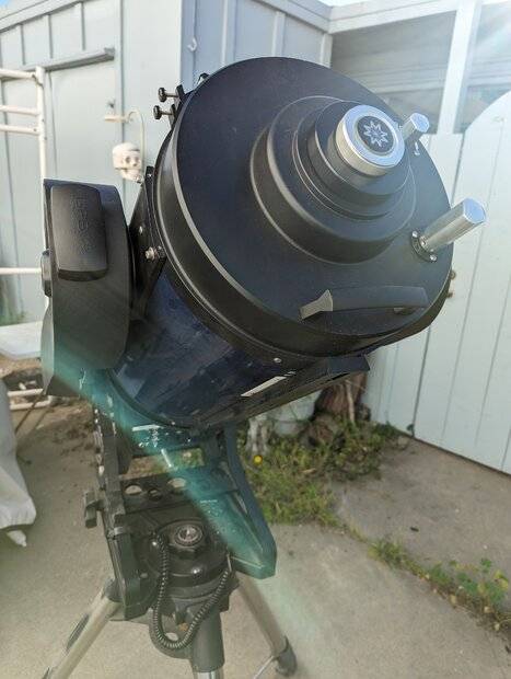

Black equatorial wedge mounted on a silver three-legged tripod, standing on a concrete patio. A partial black telescope case is visible at the lower left.
Figure 5. Tripod and equatorial wedge.

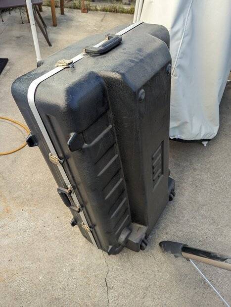

Black hard-shell equipment case with silver metal trim and a carry handle on top, sitting on a concrete patio beside a white cover and a yellow hose.
Figure 6. All packed up for now. Waaahh! :H I miss you already and love you sooo much! Waahh! :H

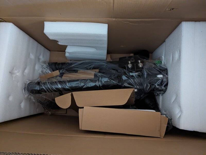

Some progress made.

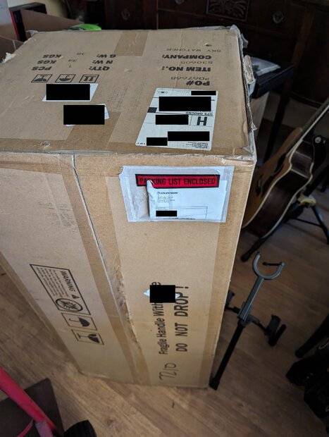

Here's the box that contained the pier tripod.
(Also shipped with the pier tripod were a couple of counterweights [not shown], but were packaged separately, in addition to a third counterweight that I purchased separately.) The mount head was shipped separately, in its own box [also not shown here].
Large cardboard shipping box on a wooden floor with printed handling symbols, 'Fragile Handle With Care' and 'Do Not Drop' text, and a packing list envelope marked 'Packing List Enclosed' on its side.
Figure 1. Pier tripod box. This one looked a bit more beat-up than the other boxes.
Open cardboard box with foam corner inserts, containing a black telescope tripod wrapped in plastic film, with a small cardboard divider and loose packaging pieces around it.
Figure 2. Contents of the pier tripod box immediately after opening. Uh, oh. That doesn't look quite right.
It seems the pier tripod box didn't do so well in the shipping. Fortunately nothing is missing or broken. But, yeah, there are some superficial scratches to the finish, since some of the items were banging around loose. Otherwise it looks to be fine. I'll chalk it up to battle scars.
Black pier tripod for a telescope mount standing on a wooden floor in front of cardboard boxes, with a white-topped mounting plate, a threaded stud, and a green knob on the side.
Figure 3. Pier tripod directly out of the box. I guess it survived quite well.
I moved the pier tripod outside, and man, that thing is heavy. I am out of shape, but even if I wasn't, man, that thing is solid and heavy.

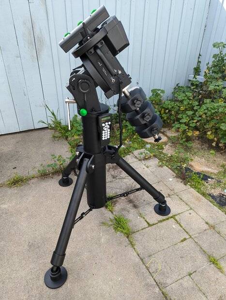

The mount head was packaged separately, and that box fared just fine. No problems on that front. the mount head is also heavy, but the built-in handles helped a lot.
Black equatorial telescope mount head with a counterweight shaft, mounted on a black tripod pier with chain-linked legs, standing on a concrete patio.
Figure 5. Mount head attached to pier tripod.

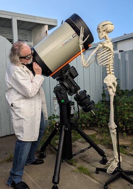

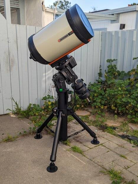

And now for the optical tube assembly (OTA).
Cardboard shipping box on a wooden floor, labelled CELESTRON, with Item No. XLT and Description: Optical Tube Assembly 14" EDGE-HD, Qty: 1, and red TEAM LIFT label on the top right.
Figure 2. C14 EdgeHD in its box.
A man in a white lab coat and dark glasses adjusts a equatorial telescope mount on a tripod outdoors, with a white and orange telescope tube resting on a cloth beside it.
Figure 3. OTA ready to be attached to mount. If I can figure out how to lift it up on the thing, that is.

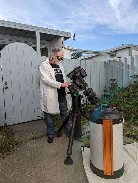

Getting the OTA lifted up and attached to the mount was a bit tricky, and there was an aborted attempt as a first try. I eventually engineered a solution [not shown] involving 1) removing the counterweights, 2) lifting the OTA up onto a small but sturdy side-table such that the OTA is resting on its lens cap, 3) attaching the OTA to the mount's saddle such that the counterweight shaft is in the horizontal position, 4) re-installing the counterweights to achive right ascension (RA) balance while the OTA is still safely on the table, and 5) carefully rotating the RA and declination (Dec) back to home position (lifting the OTA off the table in the process) and then adjusting the OTA's position in the saddle to achieve Dec balance.
Man in a white lab coat and dark glasses looks through a large Celestron telescope on a black tripod mount, beside a human skeleton model with its hand on the telescope tube.
Figure 4. While it is technically possible for one person to attach to the OTA to the mount, it really aught to be a two person job.
Celestron C14 EdgeHD telescope on a equatorial mount atop a black tripod, standing on a paved patio in front of a white fence and shrubs.
Figure 5. Pier tripod, mount, and OTA all together now.
More to come ...

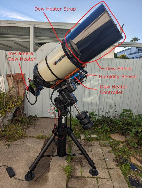

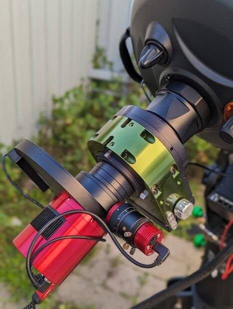

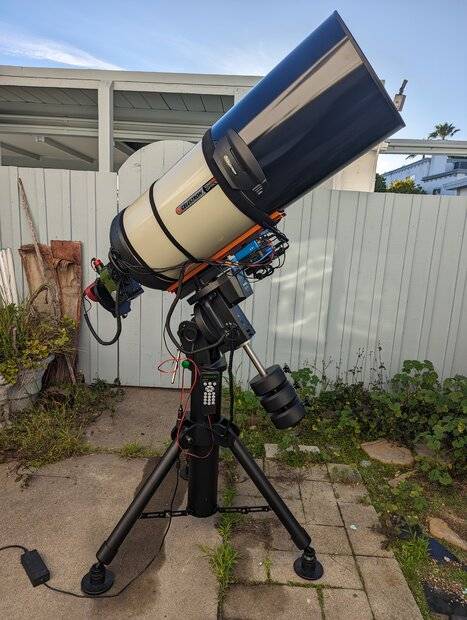

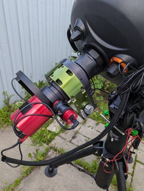

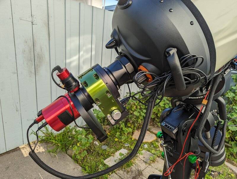

More progress.
I attached most of the camera and control peripherals, and got everything pretty much balanced today. Always remember when balancing your scope: Dew shield on and lens cap off, just like you would when imaging. That includes making sure the camera is attached.
Large Celestron-style Schmidt-Cassegrain telescope with cream optical tube and black dew shield, mounted on a black German equatorial mount and tripod in a backyard, with cables and a power box attached.
Figure 1. More progress getting things attached to the scope.

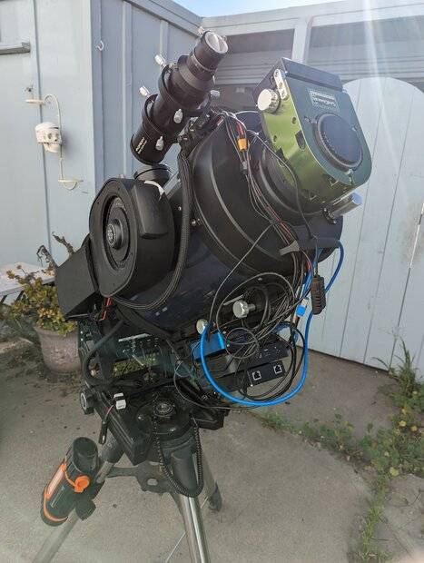

Photo of a telescope with a red and green astronomy camera, a focal reducer and an off-axis guider attached at its rear, mounted on a black equatorial mount with cables and a power box.
Figure 2. From right to left (after the telescope): focal reducer, focuser, off axis guider (OAG), filter wheel, and camera. The spacing is just about right for the ideal 146.05 mm of backfocus (spacing between the reducer and the sensor plane) of the C14 EdgeHD + reducer.
Cable management is off to a good start. But I should eventually secure the cables better before all is said and done.

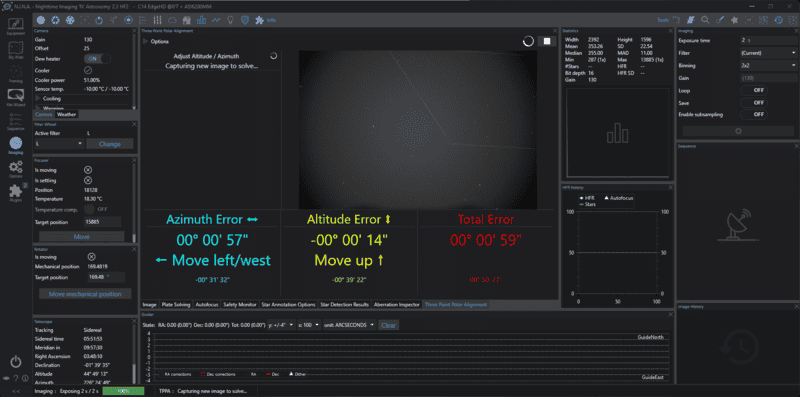

Screenshot of N.I.N.A. Advanced Sequencer software showing the Three Point Polar Alignment panel, with Azimuth error 00° 00' 57" (move left/west), Altitude error -00° 00' 14" (move up), and total error 00° 00' 59".
Figure 4. I was also able to get polar alignment off to a start.

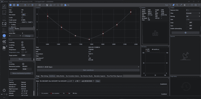

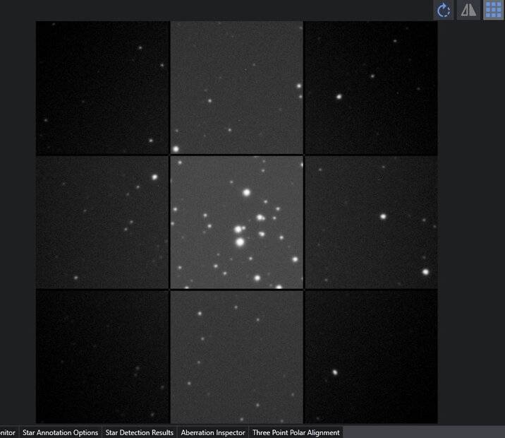

Screenshot of N.I.N.A. autofocus run showing a V-shaped HFR versus focuser position graph, with points between about 14000 and 22000 and the lowest point near 18000.
Figure 5. The sky was clear enough to calibrate the focus offsets for the filters.
Calibrating the filter offsets (focus offsets for the filters) is a tedious process, but very beneficial in the long run. The idea is to calibrate and record the difference in optimal focus between the L filter and each of the other filters. Then when imaging, N.I.N.A. automatically switches to the L filter for focusing, then after the autofocus, applies an offset to the focus position before switching back to the filter to be used. This can allow you to speed up the autofocus routine significantly when imaging, saving precious time.

collinsmark said:
Here's the mount with counterweights attached. I also moved the whole thing a little bit to the north, in an effort to optimize my sky area.

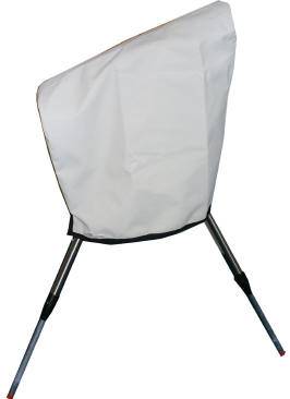

http://www.telegizmos.com/365 sizes and prices page 2.htm
White fitted cover draped over the top of a telescope tripod's legs, shown against a plain background.
These things are a game changer. They protect the equipment from direct sunlight, rain, storms, the whole kit-and-caboodle.
Amateur astronomy has an old saying, usually given to advice to people looking to buy a new telescope, "The best telescope is the one that gets used." It is good, sound advice.
And these TeleGizmos 365 series covers fit right into that mantra. I have nothing but good things to say about these products. They are 100% at or near the top of my favorite pieces of astronomy equipment.

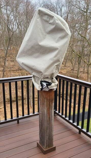

Yeah, my mount is almost old enough to vote, and spends most of its time outside in the northeast US. Since I installed the pier in 2017 it has only left the deck a handful of times, to travel. I do also leave telescopes out for a few days at a time if I know I'm going to get good weather for imaging. And for the eclipse coming up, I hope to set up the night before so I can get a decent polar alignment. [edit] My biggest risk isn't the environment when it's under cover, it's condensation overnight while I'm using it. It's often not much less than if it had been rained on.
Beige fabric cover tied over the top of a wooden deck post, with a black cord cinched around its base, on a wooden deck with black railings and bare trees behind.

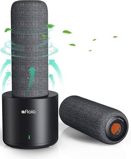

I use a "rechargeable" desiccant cartridge marketed for the guns and ammo community. I have an extra cartridge. Every time I uncover the telescope I'll swap the moist and dry cartridges in the "charging"/drying receptacle, such that there's always a dry one at the ready.
Photo of a black cylindrical dehumidifier unit with a grey fabric cover and a green indicator light, next to a second grey fabric-covered cylinder with an orange desiccant window labelled Drying and Reactivating.
Before putting the cover back on the telescope, I'll take the dry cartridge, put it in a mesh bag, and hang it on the telescope.
Product photo of a black mesh drawstring bag on a white marble background, with a green banner reading Universal Sizes of the Multifuction Bag, 5 Pack, and dimension labels of 11,4 in height and 7,48 in width.
So far, this method has worked fine for me. But again, there are other methods. I've heard of some people even using clumpable cat litter.
