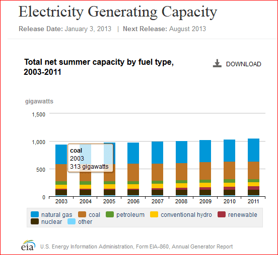

nikkkom said:
Then you have a problem with simple math. 150x150 square miles of solar arrays
Maybe.
https://www.eia.gov/electricity/capacity/
a thousand gigawatts X 24 hours/day = 24X10^12 wh/day =2.4 E10kwh/day

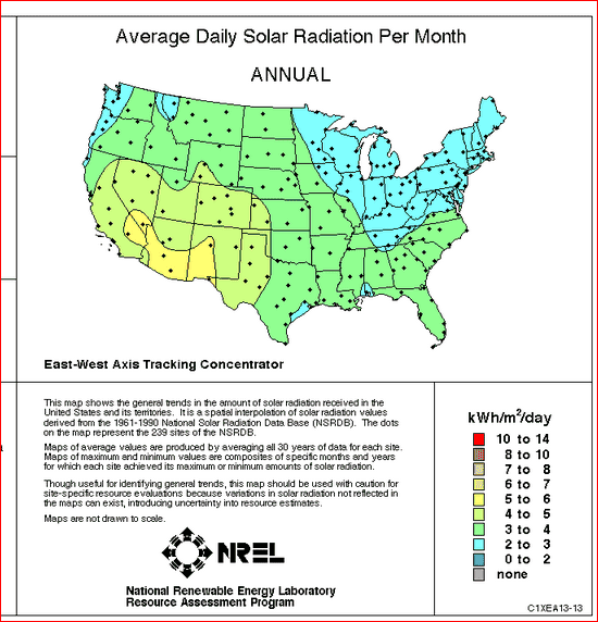

I take that 150 X150 miles as roughly 241 km X 241 km
which = 5.81E10m^2http://rredc.nrel.gov/solar/old_data/nsrdb/1961-1990/redbook/atlas/
Let's take 5kwh/m^2/day in southern Arizona & New Mexico
5kwh/day/m^2 X 5.81E10m^2 = 2.90E11 kwh/day is what falls on the collectors

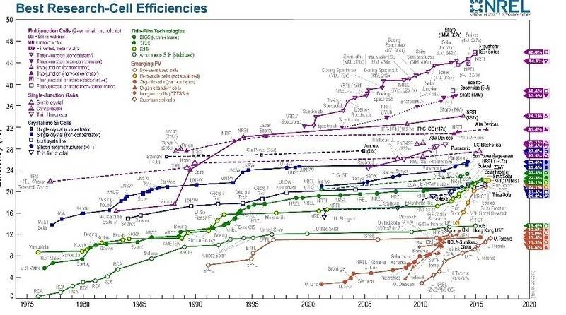

Efficiency = output(electric kwh) / input(solar kwh)
2.4E10/ 2.90E11 = 0.082
If you can collect, store and distribute it at >8.2 % efficiency your numbers are right.
Looks like the solar cells themselves will not much longer be the limiting factor.
Be sure to see original at http://www.nrel.gov/ncpv/ click "Latest Chart"
There'll be some splendiferous grid crashes and battery explosions along the way -
but i say to your generation : Go for it. We ought to leave some fossil fuel near the Earth's surface for whatever species replaces us.
My run is over, it's you young folks turn.
As my childhood hero said "Hi - Yo Silver, Away !"
(Exit stage left to William Tell Overture...)

mheslep said:
Backing up a future US for a conservative 7 days all by battery, with all energy needs made electric at load 2 TW, is 336 TWh. Such a battery ...
Total installed capacity of US today is 1 TW, not 2. Average consumption is, naturally, much less that 1 TW.
