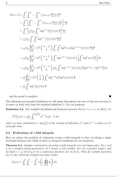

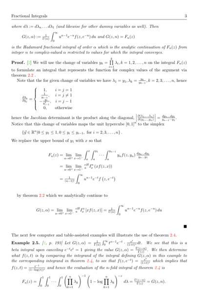

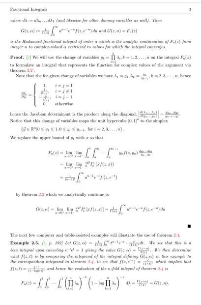

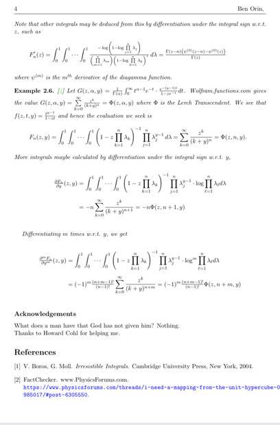

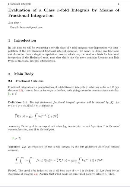

The note is entitled: Evaluation of a Class of n-fold Integrals by Means of Hadamard Fractional Integration. 4 pgs pdf format.
I assure you that you need not know anything about fractional calculus at all to understand this note that Howard Cohl helped me with. We only use a single interpolation theorem from fractional calculus to establish the result. Examples are given.
I was a lowly undergrad (senior math major) when last I was in school so I’d appreciate it if you more experienced Analysis ppl would give my proofs a once over please?
Thank you,
-Ben
I assure you that the attached pdf file does not contain viruses nor malicious macros, etc. just math. Promise.

Images of each page of the pdf I will post here for a safe viewing experience.

In the equation in Theorem 2.2 are you missing a ##\frac{1}{t}## on the left hand side?
I don’t think so. I did look at it tho.
Noticed a page was missing from my #2 post in this thread (the screens, not the pdf), it has been edited in.
