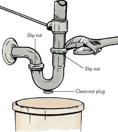

Folks,
I have an application that will require an air inlet port to occasionally be exposed to water (splashing mostly), a simple splash guard will likely not work. Are there any off-the-shelf or simple solutions that anyone can think of that can be used for keeping the water from entering the inlet port? I can probably make the air inlet port very small since it will require only a very small amount of air.
Thanks in advance!
John
How about a drain catch with a way to get any water out that may get in?
Even just making the intake vertical could make it very difficult to get water in it...
Thanks, great idea. The problem is I can't rely on gravity since the device orientation can change.
What range of orientations does it need to be able to operate in?
It could pretty much be in any orientation. It will be worn by a person and they can stand up, lie down, lean sideways, etc.
