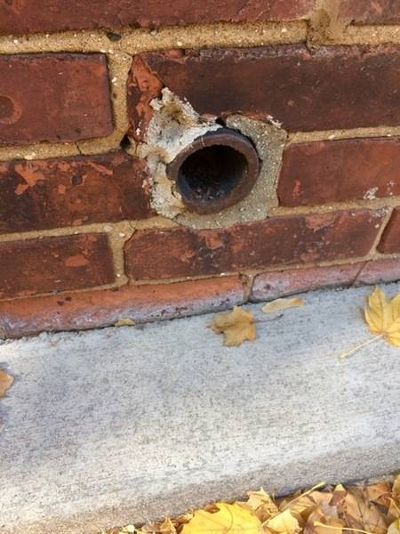

I found this drain pipe covered with leaves and earth. It might be from old gutter drainage. Any ideas on capping it?
If it still communicates with a storm drain, then it might be draining that area of yard when it rains. Capping or plugging could cause floods. Might be better to reconnect it to the roof gutter.russ_watters said:No, I would not fill it in with dirt. There is no telling how many other drains in the area connect to it near the bottom of that leg: you may be dumping dirt into a big storm drain!
It was disconnected when the gutter down spout was moved. Maybe put a mesh over it?zoobyshoe said:If it still communicates with a storm drain, then it might be draining that area of yard when it rains. Capping or plugging could cause floods. Might be better to reconnect it to the roof gutter.
I think you could test it by running the garden hose down it for a few minutes. If it seems to be filling up, it's already plugged. If not, then it may well be draining the yard there when it rains.
Wirenut raises the possibility it might have lead to the sewer in an old combined system. That being a possibility, I don't know what to tell you. I would point out, though, that it doesn't seem to have caused any problems as is.Greg Bernhardt said:It was disconnected when the gutter down spout was moved. Maybe put a mesh over it?
One should try to find a survey of the property. Is there an inspection report?Greg Bernhardt said:I found this drain pipe covered with leaves and earth. It might be from old gutter drainage. Any ideas on capping it?

Are you referring (in the first pic) to the small black thing coming from bottom right? If so I enlarged the pic and that looks like a plastic tie wrap (yard debris).edward said:In the first picture it looks like there is a small diameter pipe coming in from the side. It could be a condensate drain line so make sure not to plug it or bend it until you are sure. It could also be a drain line from a hot water heating system.
The second picture looks like a drain so that storm water doesn't build up behind the wall. I am presuming that ground level is higher on the other side of the wall.
Agreed: it looks like a retaining wall drain.edward said:The second picture looks like a drain so that storm water doesn't build up behind the wall. I am presuming that ground level is higher on the other side of the wall.
