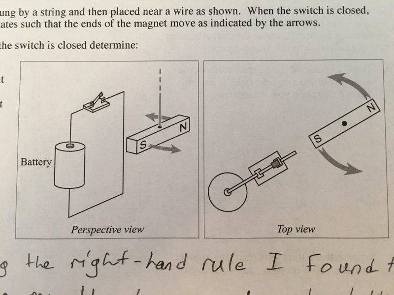

There are two problems:
1. At the instant the switch is closed determine the direction of the net force exerted by the magnet on the wire segment at the instant that the magnet is in the position shown. Explain.

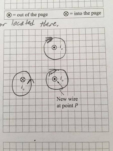

2b. Suppose the a third wire, carrying another current i0 out of the page, passes through point P. Draw a vector on the diagram to indicate the magnetic force, if any, exerted bon the current in the new wire at P. If the magnitude of the force is zero, indicate that explicitly. Explain your reasoning.
I don't think there is any relevant equations since this is all theoretical actions.
For problem 1 I didn't know how to go about it so I used Newton's Third Law. In the previous part they wanted me to find the direction of the current through the wire and by using the right-hand rule I found the current to be ccw so the B-field must point toward the magnet. Now using Newton's Third Law I said that since there must be an equal and opposite force then the net force exerted by the magnet must be towards the wire or the opposite direction of the B-field produced by the wire. Is this reasoning correct? I feel like the wire should have a net force to the right allowing it to be repulsed by the B-field.
For problem 2 I drew the currents around all three wires using the right-hand rule and immediatly got confused on how to determine the direction vectors. I want to say it will be straight down since the left wire will cancel out with the right wire thus leaving only the top wire to exert a magnetic force.

Let's make one step back. From the text that you could easily have rendered in the full problem statement but cut off partly in a picture, I can read :
...ung by a string and then placed near a wire as shown. When the switch is closed
...ates such that the ends of the magnet move as indicated by the arrows
... the switch is close determine:
[edit]wrong button. If the magnet ...ung by a string moves as the arrows indicate, which way is the magnetic field inside the current loop ?

Ok I uploaded an image of the entire first problem with my reasoning to the first problem already written there. I want to believe based on the image that the current is ccw and thus there is a B-field into the page. (Hard to describe through words). Based on that observation then I wanted to believe that there would be a net force from the magnet to the left pointing toward the wire since the wire would exert a force to the right at that position, but I am really now just confused on what the overall problem is looking for me to do.

Your description looks reasonable. To solidify your understanding you might google: "Oersted experiment"

jlmccart03 said:
So how do I go about doing the second problem?
You should know that we generally do not allow multiple separate problems in a single thread. This is to avoid having the confusion of separate discussions taking place at the same time. It would be preferable for you to start a separate thread for the second problem.
