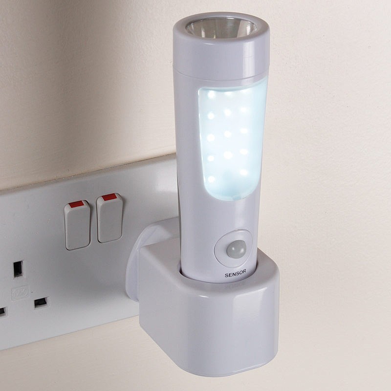

Do you mean the total effective luminous power of the Moon, or do you mean what size lightbulb would be the equivalent of the Moon's illumination through a window in your home at night?
