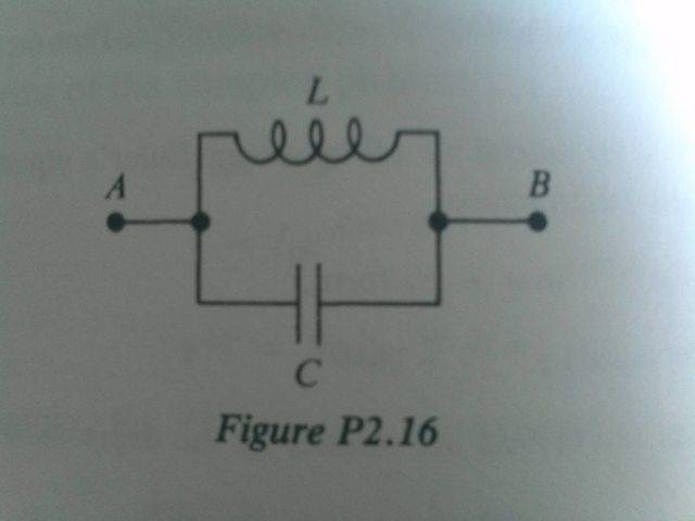

What is the impedance of a tank circuit at resonance?
In summary, the impedance of this circuit can be determined by calculating the inverse of the admittance, which is found by subtracting the inverse of the product of the angular frequency (w) and the capacitance (C) from the inverse of the product of w and the inductance (L). When w = 1/sqrt(LC), the impedance becomes infinite due to the current in the capacitor and inductor being out of phase.
drumercalzone
a) Determine the impedance of this circuit.
b) What is the impedance when [itex] \omega = \frac{1}{\sqrt{LC}} [/itex]
I think I have part a:
[tex] Z = j({\omega}C - \frac{1}{{\omega}C}) [/tex]
EDIT: I got the Z wrong. It's [tex] Z = \frac{L}{C(j{\omega}L - \frac{j}{{\omega}C})} [/tex]
[STRIKE]For part b, I'm getting that Z = 0 simply by substituting in [itex]\omega[/itex].
Is this correct? [/STRIKE]
This gives an impedance of [itex]\infty[/itex]
I feel more confident is this answer. I'm guessing that the current in the capacitor and inductor are out of phase by [itex]\pi[/itex] causing what appears to be an infinite impedance. I'm still curious as to the exact reason though, if anyone could lend help. Thanks!
Y = jwC - j/wL = j(wC - 1/wL) = j(w^2LC - 1)/wL
Z= 1/Y = jwL/(1 - w^2LC)
