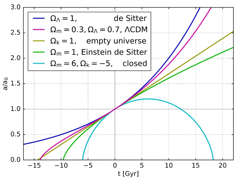

I have two problems problem with the "empty universe". If it's completely empty, it can't expand, but its scale factor function is linearly increasing, so it's ##a(t)=t/t_0## where ##t_0## is the age of the universe. The second problem with linear function of the scale factor is that the integral of its inverse is $$\int\frac{dt}{t/t_0}=t_0\ln{t}+C$$ and the proper distance equal to the observable universe radius is $$d(t_0)=a(t_0)\int_{0}^{t_0}\frac{cdt}{a(t)}$$ $$=\frac{t_0}{t_0}\int_{0}^{t_0}\frac{cdt}{t/t_0}=ct_0(\ln{t_0}-\ln{0})$$ $$=ct_0\ln{\frac{t_0}{0}}$$ It's undefined, because ##\ln{0}=-\infty##.
What's the explanation or solution to these problems?

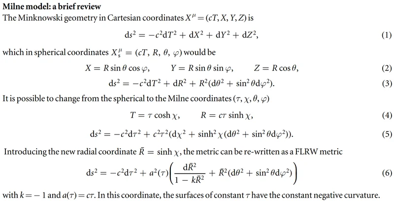

##\Omega=1## is just flat empty Minkowski spacetime as described in peculiar coordinates that involve a scale-factor expanding linearly with the time coordinate. Look up the "Milne model" and see this PF discussion:

With an appropriate choice of coordinates, yes. If you compute the Riemann curvature tensor for that metric tensor in those coordinates, you will find that it vanishes, indicating that the spacetime is flat. The funny coordinates just obfuscate that fact somewhat.
What expands in the "empty universe" is the set of worldlines that are defined as "comoving"--more precisely, that congruence of worldlines has a positive expansion scalar. In ordinary inertial coordinates on flat Minkowski spacetime, this congruence of worldlines is the set of all timelike geodesics that emerge from the origin. The funny coordinates of the "empty universe" model use proper time along these worldlines as the time coordinate, and arc length along curves of constant proper time from the origin (which in ordinary inertial coordinates are hyperboloids with the future light cone of the origin as asymptotes) as the definition of "spatial distance" (i.e., those hyperboloids are the "surfaces of constant time" in the empty universe model).

Is not really meaningful in this model. Mathematically, as you point out, it's undefined. Physically, the concept of "observable universe" doesn't really make sense in this model, because conformally it doesn't look like the other FRW models, since it's just flat Minkowski spacetime in funny coordinates, and conformally flat Minkowski spacetime looks very different from any FRW spacetime that has nonzero stress-energy in it.

Well, I think it was originally a serious proposal for a cosmology and it remains the zero-mass member of the FLRW family of spacetimes. But basically, yes. In the usual Minkowski/Einstein coordinates your "stationary points" are a set of parallel lines. In Milne coordinates they're the future half of the set of timelike lines passing through an arbitrarily chosen event.
So in Milne coordinates they are no longer parallel, since they have to cross at the event, right? Either past or future event.
Yes. They expand out from that event, and would be the paths comoving galaxies followed if there were any mass to form galaxies. Milne coordinates only cover the interior of the future light cone of that event.
