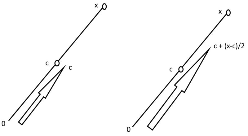

For a point ##x## on the boundary of the closed ball, why not just approach it by the sequence that goes along the line segment from ##c## to ##x##, starting at ##c## and at each step jumping to halfway between current location and ##x##. You should be able to prove that converges to ##x## and that all its points are in the open ball.
Ok, here's what I've did:
I started drawing an intuitive ( non-precise ) picture of what you've said,
I've noted that In the attempted proof I gave I had mistaken with the arbitrary ## r ## I introduced with the ## r ## given in the question. Here's my attempted proof based on your idea:
Let ## \tau \in cl(B(c,r)) ## be arbitrary. Hence ##d(c,\tau) \leq r##.
Take the sequence ## (x_m) \subseteq \mathbb{R}^n ## defined as follows,
For every ## m \in \mathbb{N} ##, ## x_m = c + \sum_{k=1}^{m}\frac{\tau-c}{2^i} = c + \frac{1}{2}\cdot(\tau-c)\sum_{k=0}^{m-1} \frac{1}{2^k} = c + ( \tau - c)\cdot(1-(\frac{1}{2})^m) ##
Note that ## \lim_{m\to\infty}x_m = \tau ##.
Also note that ## x_m ## is a vector equation, meaning that for all ## 1 \leq i \leq n ## , ## (x_m)_i = c_i + ( \tau_i - c_i)\cdot(1-(\frac{1}{2})^m) ##, from this, note that ## (x_m) \subseteq B(c,r) ## since for all ## m \in \mathbb{N} ## we have that ## d(c,x_m) = \sqrt{ \Bigg( c_1 - \bigg( c_1 + ( \tau_1 - c_1)\cdot(1-(\frac{1}{2})^m) \bigg) \Bigg)^2 + \cdots + \Bigg( c_n - \bigg( c_n + ( \tau_n - c_n)\cdot(1-(\frac{1}{2})^m) \bigg) \Bigg)^2 } =
( 1 - (\frac{1}{2})^m ) \sqrt{ ( \tau_1 - c_1)^2 + \cdots + ( \tau_n - c_n)^2 }.## Since ## d(c,\tau) \leq r ## we can see that ## d(c,x_m) < r ##, hence ## (x_m) \subseteq B(c,r) ##. So since ## \lim_{m\to\infty}x_m = \tau ## and ## \tau ## was arbitrary, we're finished.Do you think this is ok?

andrewkirk said:
@CGandC Yes your proof works.
