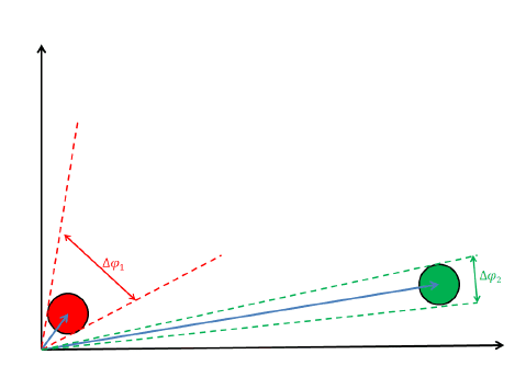

Is there any theoretical prediction in QM regarding the increase of coherent length through a series of stimulated emissions as it seems to happen in the linear cavity of a ruby laser setup?
Hi All,
When I teach the basic structure of a laser setup, stimulated emission appears as a fundamental phenomenon. But in no reference I found a description that could account for the increase of coherent length of the EM laser field. According to my knowledge, one photon typically doesn't have even 1% of the coherence length of a laser beam. Sometimes I wonder if in each stimulated emission, the photon released by the atom stimulated by the passing resonant photon couples with it in a way that enlarges a bit the coherent length (as in situation B of figure bellow). But the most frequently found illustration for stimulated emission is similar to figure A.
My question is:
Is there any theoretical prediction in QM that aims at providing an elementary explanation of this increase of spatial coherence? Is there any reference that deals with this subject specifically?

I understand you are taking a semi-classical point of view, as you are dealing with EM fields that can be represented by sort of well behaved functions of time. My point here concerns the elementary quantum process of stimulated decay, as depicted in my attached figure in OP. Does the stimulated emission occur with an elementary increase of spatial coherence? (I know it is connected with time coherence as well)
My point is: A or B? and theoretical justification.
Well, stimulated emission is not really that quantum. In contrast to spontaneous emission, which really needs a lot of qm and in principle even qft for a correct description, stimulated emission and a classical driven antenna or dipole are not really different and a semiclassical approach works perfectly.
If you insist on translating it to a quantum picture: The excited state of an atom is stable in the absence of any external perturbation. So you need an external perturbation to put it into a superposition of the excited state and the ground state. Such a superposition state yields a time-varying probability amplitude for the spatial distribution of the electron and is akin to the quantum version of "accelerated charges radiate".
However, you do not have time-varying electron densities, but probability amplitudes. So these also do not get converted to photons, but to probability amplitudes for the a photon being added to the light field in the cavity. In the simple case of a single emitter, you would get an entangled state, which goes back and forth between the atom being in the excited state and the cavity containing n photons and the atom being in the ground state and the cavity containing n+1 photons. For spontaneous emission, the coherence time will be given by how long this superposition can be kept alive.
For stimulated emission, you instead usually have lots of emitters and lots of photons. So, if you want a mental picture, you rather have a collective superposition of many emitters and the cavity field. Still the basic picture of is similar. However, the state is obviously less prone to perturbartions to the atoms as dephasing of one atom out of 7 million atoms interacting with the light field is not as critical as dephasing of the only atom interacting with the light field.
Are you familiar with quantum optics in phase space?
If so, on a different note you can see the enhanced coherence time directly by plotting the Wigner function of the different states in phase space. Coherent states are essentially displaced vacuum states. with the displacement being equivalent to the coherent amplitude. Now as you increase the displacement, you can keep track of how well the phase of the state is defined. While it is completely undefined for the vacuum, the range of possible phases obviously becomes narrower, so the phase becomes defined better when increasing the displacement. As the displacement corresponds to the amplitude of the light field and is therefore directly related to the mean photon number of the light field, increasing the mean photon number of a coherent state automatically results in a better-defined phase and therefore enhanced coherence.

Well, the displacement operator e.g. determines the amplitude of a coherent state. And as you increase the mean photon number via stimulated emission, you just increase the coherent amplitude. It is just important to understand that the exponent of the displacement operator is a sum of annihilation and creation operators. So it is related to fields, not photon numbers (which are products of creation and annihilation operators). Actually, single photons are pretty irrelevant to stimulated emission in lasers. In lasers, you usually do not encounter any situation, where you have a well-defined photon number inside the cavity and you add exactly one to it via stimulated emission. Such pictures are pretty misleading. Stimulated emission is a phase-sensitive process and as such understood best in a field picture. The phase sensitive amplification essentially corresponds to increasing the coherent amplitude.
As you say that you are familiar with quantum optics in phase space: Below, the Wigner functions of two different coherent states are depicted (where the amplitude is not represented faithfully, but binary - all values above some threshold value are shown in one color and all values below threshold are just white). One has a small mean photon number and one has a larger mean photon number. As you can see, the figure also shows the phase uncertainty of the two states and the state of larger photon number clearly has a smaller phase uncertainty. This automatically results in enhanced coherence. Actually stimulated emission will result in "extending" this displacement vector and you the Wigner function gives you the relative weights for extending it along the corresponding direction. Obviously, due to this, the distribution will get narrower in phase space as the amplitude increases.
With respect to your A and B: I think this is misleading. It may be useful to discuss this picture for stimulated emission from a single isolated atom, but it is not the most useful picture for lasers.

A single photon has a well-defined meaning. It is a highly non-classical state of a quantum field with an excitation number of exactly 1 and no photon number uncertainty. My emphasis is that for example having a coherent field of mean photon number 7 (and the typical photon number uncertainty of a Poissonian distribution), going to a mean photon number of 8 (also with some photon number uncertainty) via stimulated emission is a completely different thing than having a coherent field of mean photon number 7 and adding a single photon (without any photon number uncertainty) to it. The first state is pretty classical, while the second state will have non-classical features.

Well, you still would need to know the mode (spectral width) of the light field and whether the state is stationary and will show diffusion in phase space over time. Just for the record: For pretty much every real laser, the coherence time is actually given by mechanical or similar instabilities.

The displacement operator contains an infinite number of infinitesimally small translations of the field. That is a reasonable way to represent it. As a mental picture, I would always consider the atom as a driven dipole. QM really has pretty much nothing to add here.

Well, the Wigner function is only defined with respect to some mode of interest. In experiments this would be given by a local oscillator acting as a reference. The properties of this reference define the mode of interest, which includes temporal duration and spatial shape of the mode. The same mode of a light field may result in very different Wigner functions with respect to different reference beams. You of course need to know what this mode is to be able to interpret the Wigner function.
