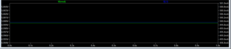

I am trying to understanding the inductor circuit. I have drawn the below circuit and try to simulate
The Inductor current comes to 500mA and Vout is 5V as per simulation. The current in inductor should slowly increase from 0A to 500mA but i cannot see that in the waveform. Is my understanding correct?

This is the output waveform i can get. Ok now i started writing the equation for the circuit.
##i(t) = \frac{V} {R} (1 - e^{\frac{-Rt} L})##
Substituting the values
##i(1) = 5/10*(1 - e^{-10^5}) ##
##i = 0.5A##. The answer is matching.

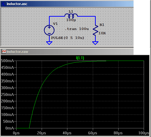

So zoom into the first few us of the transient waveform to see the LR time constant...
The DC analysis sets up 500 mA before the run.
You must use; V1 pulse; initial=0V; Von=5V; Tdelay=5usec;
and .TRAN stop time = 100 usec.
Then see the current rise over about 50 usec.
