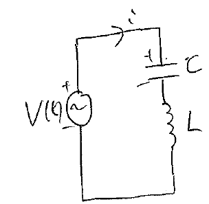

1) Why does there have to be an inductor to generate a voltage opposing the source voltage? Doesn't the circuit create back voltage without an inductor?
2) In ##U = \frac{1}{2}LI^2 + \frac{1}{2}\frac{Q^2}{C}##
##E = \frac{1}{2}mv^2 + \frac{1}{2}kx^2## where ##x(t) = Acos(wt + \phi)##
following this pattern where ##k = \frac{1}{C}## and x = Q, ##q(t) = q_0cos(wt+\phi)##, m = L, v = I; could x= I and k = L so that ##I(t) = I_0cos(wt + \phi)##?
1) Yes any circuit loop as a closed loop of current has some self inductance and creates some back EMF. But this self inductance is usually very small and we choose to ignore it. It comes into play only when the other factor of the back EMF, ##\frac{dI}{dt}## is very large, like when opening or closing a switch of the loop.
2) Yes you could have the I(t) you proposing but the analogy isn't perfect now because current is the first derivative of charge as velocity is the first derivative of position.

Ok, 2) makes sense, but I am wondering more about 1)
Doesn't the back emf in the inductor only come into play when the dI/dt is large like when opening or closing the switch of the circuit (like in the self-inductance of the circuit)?
Are you familiar with the basic differential equations relating voltages and currents for inductors and capacitors?
$$v(t) = L \frac{d i(t)}{dt}$$
$$i(t) = C \frac{d v(t)}{dt}$$

I'm not sure, which circuit you are really discussing here. From #1 it seems to be a capacitor and a coil in series connected to an AC voltage ##V(t)=V_0 \cos(\omega t)##.
In the above diagram the arrow indicates the orientation of the line integral in Faraday's Law,
$$\int_{\partial A} \mathrm{d} \vec{r} \cdot \vec{E}=-\mathrm{d}_t \int_A \mathrm{d}^2 \vec{f} \cdot \vec{B}.$$
This line integral gives, taking into account the chosen "polarities" of the voltage source and the capacitor,
$$\int_{\partial A} \mathrm{d} \vec{r} \cdot \vec{E}=-V(t)+C Q.$$
The magnetic flux has to be calculated with the surface-normal vector going into the plane and in this direction also is the magnetic field. So you have
$$-\mathrm{d}_t \int_A \mathrm{d}^2 \vec{f} \cdot \vec{B}=-L \dot{i}.$$
Together with ##i=\dot{Q}## you get
$$-V(t)+C Q=-L \ddot{Q}$$
or
$$L \ddot{Q} + C Q=V(t)=V_0 \cos(\omega t).$$
It's of course a bit artificial, assuming that there's no resistance (at least the coil in reality has some resistance, which you can put in series with the ideal coil which adds a term ##R i=R \dot{Q}## on the left-hand side of the equation).
