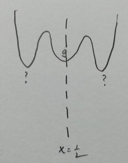

There is still the possibility however that the curve has other minimums other than on its line of symmetry:
Can it be shown without calculus that this hypothetical case is impossible?
After your first argument that ##x+ y =1##, try, without loss of generality, ##x = \frac 1 2 + z##, ##y = \frac 1 2 -z## and simplify the expression in ##z##.
The case shown in this drawing (symmetric minimums around the main minimum) must be impossible because there simply aren't enough powers to make all those inflection points.
@bob012345 i was thinking along those lines, but could not recall the theorem that links the number of inflection points to the degree of the powers of ##\frac{1}{x^n}##. Could anyone state that particular theorem, please?
Likes bob012345
I should have said maxima and minima which is what I meant, not inflection points which are different. Anyway, it's going to be one less than the degree of the polynomial since one takes the derivative and sets it equal to zero to find the extrema. For example you would need a sixth degree polynomial to get the five extrema in your drawing but as I understand it not all sixth degree polynomials will have that many extrema.

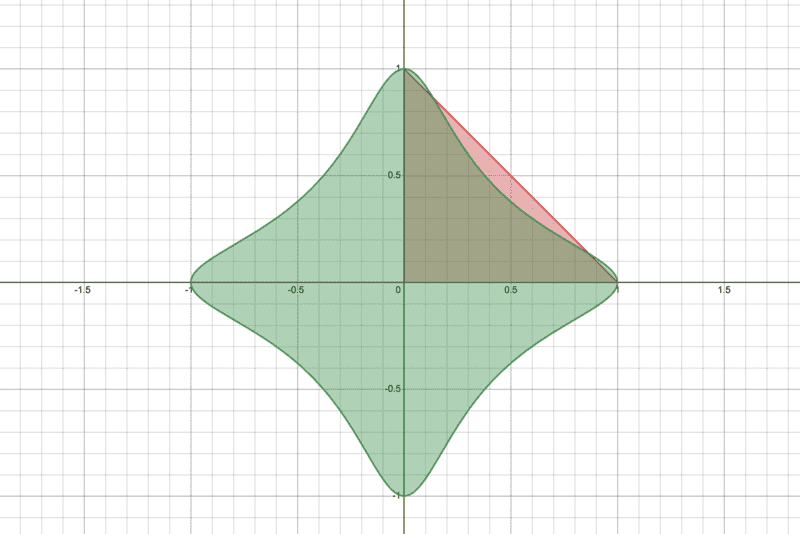

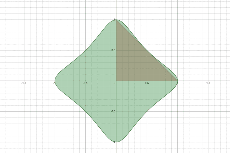

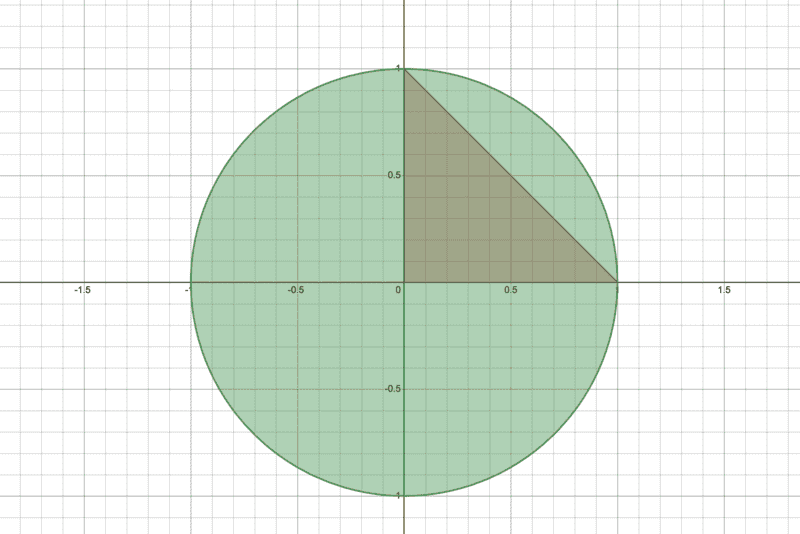

This isn't a proof but if we let the function be greater than some unknown ##n##
$$f(x,y)=\left(1-\ \frac{1}{x^{2}}\right)\left(1-\frac{1}{y^{2}}\right)>=n$$ we can also write it in this form
$$x^2+y^2 <=1-(n-1)x^2y^2$$ when ##n=1## it is a unit circle but we can also see that this curve will intersect a circle ##x^2+y^2=\frac{1}{2}## on the edge of our domain and the line ##y=x## at point {##\frac{1}{2},\frac{1}{2}##}.
$$x^2+y^2 =\frac{1}{2}=1-(n-1)\frac{1}{16} $$ giving ##n=9##
Graphically, letting it plot in all quadrants because it looks nice and plotting it over our domain of interest it shows that the curve doesn't contain all the points for ##n>9##
for n=1;
for n=9;
for n=18;
