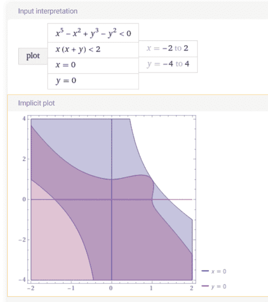

This is not an answer but an observation of the relevant graphs for what is going on. I observe a funny shape.

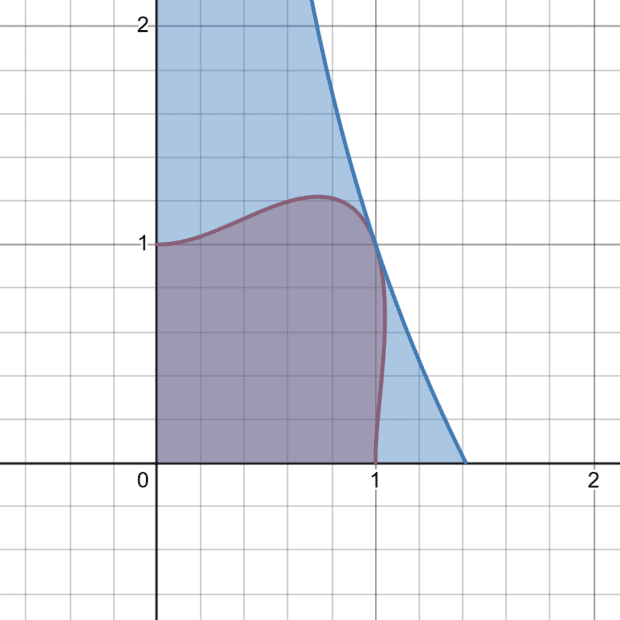

Yes, I was playing around with this and also saw the same. To expand a bit...
##x^5 +y^3 \le x^2 + y^2## with ##x, y>0## defines a region in the 1st quadrant of the xy plane as shown below:
Call this region, shaded red, ##R_1##. Call the red boundary-line (corresponding to the equality condition) ##B_1##.
Similarly ##x(x+y) \le 2## defines region ##R_2## with boundary-line ##B_2## (blue).
Overlaying these gives:
(If anyone wants to set-up/play with these graphs, see
https://www.desmos.com/calculator/og3edz9st5)
The problem stated is equivalent to showing that ##R_2## completely contains ##R_1##; i.e. that every point (x, y) in ##R_1## is also in ##R_2##.
(The converse is not necessarily true: there are points in ##R_2## that are not in ##R_1##.)
It is easy to determine that##B_1## passes through (0,1), (1,0) and (1,1) and that ##B_2## passes through (1,1) and (√2,1).
Note that (1,1) is a common point and we can show ##B_1## and ##B_2## just touch here – i.e. they have a common tangent – as follows:
For ##B_1:x^5 +y^3 - x^2 - y^2=0##
Differentiating implicitly gives:
##\frac {dy}{dx} = \frac {x(2- 5x^3)}{y(3y– 2}##
At (1,1) ##\frac {dy}{dx} = \frac {1(2-5*1)^3}{1(3*1-2)} = -3##
For ##B_2: x(x+y) =2##
##\frac {dy}{dx} = -\frac {2x+y}{x}##
At (1,1), ##\frac {dy}{dx}= -\frac{2*1+1}{1} = -3## the same as for ##B_1##.
We also note that at (1,1) ##B_1## is concave upwards and ##B_2## is concave downwards. From visual inspection ##R_2## entirely contains ##R_1##, as required. But that's no proof.

( cont. of my post #2 )
Let us name
Graph 1 : ##x^5-x^2+y^3-y^2=0##
Graph 2 : ##x(x+y)=2##
The x coordinate of the crossing point satisfies
[tex](x-1)(x^7+x^6-x^4+6x^3+6x^2-8x-8)=0[/tex]
So we now (x,y)=(1,1) is a crossing point, let us say it P.
At P by simple calculation
the gradient of graph 1 = the gradient of graph 2 = -3
The second derivative of graph 1 = 4
The second derivative of graph 2 = -54
So we show the graph 2 surpass graph 1 around point P.
This is just a local discussion around P.
The graph of the remaining part of the above crossing point equation
So as for x < 1.083... where the red dot point in the graph, we shall not have another crossing which goes with the statement.
The red point should not correspond to another crossing but the x bounded point, but I would like to get a confirmation about my interpretation.
Anyway, the above three lines I said watching the graph are not proof but a speculation.

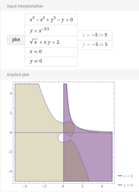

(Post script to my post #4)
We can make similar problems, e.g.,
For positive real numbers x and y
[tex]x^5-x^2+y^3-y \leq 0[/tex]
satisfy
[tex]y<x^{-3/2}[/tex]
and
[tex]\sqrt{x}+xy<2[/tex]

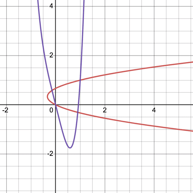

Thinking about this a little more I think we can demonstrate there is only one relevant maximum by thinking about the form of the derivatives which are used to find the maxima of the function on the RHS above;
$$x = 3y^2 -2y$$ and
$$y = 5x^4 -4x$$
From these we can deduce the following;
The first is a parabola opening to the right or positive x-axis symmetrical around the line ##y=\frac{1}{3}##, the vertex is at ##(-\frac{1}{3}, \frac{1}{3})## which intersects the y-axis at ##(0,0)## and ##(0,\frac{2}{3})## and it is monotonically increasing in the first quadrant for ##x>0## and ##y>\frac{2}{3}##,
The second is a quartic which opens towards positive ##y##, has a vertex in the fourth quadrant and has two roots one at ##(0,0)## and the other at ##(\sqrt[3]{\frac{4}{5}}, 0)## and is monotonically increasing for ##x>\sqrt[3]{\frac{4}{5}}## and ##y>0##.
There can be only one intersection of these two monotonically increasing functions in the positive quadrant which must then be at the point previously identified at ##(1,1)##. Thus this is the only maximum of the function in the positive quadrant and is equal to 2.
Though we did not require it, visually, it looks like this;
You made me use my brain a little more @Steve4Physics , thanks!
