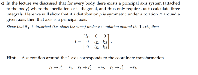

Show that if ##\rho## is invariant (i.e. stays the same) under a ##\pi##-rotation around the 1 axis, then
none
Hi,
unfortunately, I am not getting anywhere with the following task
The inertia tensor is as follows
$$\left( \begin{array}{rrr}
I_{11} & I_{12} & I_{13} \\
I_{21} & I_{22} & I_{23} \\
I_{31} & I_{32} & I_{33} \\
\end{array}\right)$$
I had now thought that I could simply rotate the inertia tensor around the angle ##\pi## using the rotation matrix for x, i.e.
1 & 0 & 0 \\
0 & cos & -sin \\
0 & sin & cos \\
I have received the following
\end{array}\right) \left( \begin{array}{rrr}
1 & 0 & 0 \\
0 & -1 & 0 \\
0 & 0 & -1 \\
\end{array}\right)=\left( \begin{array}{rrr}
I_{11} & -I_{12} & -I_{13} \\
I_{21} & -I_{22} & -I_{23} \\
I_{31} & -I_{32} & -I_{33} \\
And as you can unfortunately see, that is not the right solution at all. Unfortunately, I don't know what exactly I should calculate here to get the result.
First of all, the inertia tensor is a second order tensor so it doesn't rotate like that (how does it rotate?)
Secondly, you may want to take a look at the defining integral/sum for each of the components, assuming your lecture material contains such. What does the hint given in the problem mean in that context?

Look at the integrals for the components that you have to show becomes zero, e.g. ##I_{xy}##. What happens if you split this integral into two parts, one integral for ##y \gt 0##, the other for ##y \lt 0##?

You're assuming the rotation leaves the tensor invariant, i.e., ##I=I'##. So what does that imply about the individual elements of ##I##?

@vela that means that the objects must all be the same after the rotation, i.e. as before the rotation. In my calculation in post 9 I see that all objects except ##I_{12},I_{13},I_{21},I_{31}## remain the same. Does this mean that for an invariant rotation, I can take these objects as zero?
Thanks PhDeezNutz and pasmith for the tip, would ##I_{xy}=\int_{}^{} -\rho(r) xy \ d^3r ## then have to be as follows, with ##x=rcos(\theta)##, ##y=rsin(\theta)## and ##z=z##?
$$I_{xy}=\int_{0}^{z}\int_{0}^{2\pi}\int_{0}^{r} -\rho(r) r^3cos{\theta}sin{\theta} \ dr d\theta dz$$
If ##I=I'##, that means the corresponding entries are equal, so for example, you have ##I_{12} = -I_{12}##. What does that tell you about ##I_{12}##?

Thanks to all of you for your help
@vela, if the following holds, ##I_{12}=I_{12}## this condition can only be valid if ##I_{12}=-I_{12}=0##.
So then I can assume the following:
-I_{21} & I_{22} & I_{23} \\
-I_{31} & I_{32} & I_{33} \\
\end{array}\right) \rightarrow I_{12}-I_{12}=0 \rightarrow \left( \begin{array}{rrr}
I_{11} & 0 & 0 \\
0 & I_{22} & I_{23} \\
0 & I_{32} & I_{33} \\
\end{array}\right)$$I have one more question, if ##\rho## were not invariant, would the following hold for the above rotation ##I \neq I'## then the following would also hold ##I_{12} \neq -I_{12}##, right?

The original question was that, given ##\rho## is invariant under the given rotation, show that specific components of the inertia tensor is zero. Unless you also know or show the invariance of the density function implies invariance of the inertia tensor, i.e. ##I = R I R^T##, you cannot use that to prove the components are zero as this would be kind of circular logic. And showing the inertia tensor is invariant requires you to look at the defining integrals anyway so why not just use those integrals directly to see the end up as zero?
If ##\rho## is invariant under the rotation by ##\pi## around a given axis, then the components of the tensor of inertia transform as discussed above ##\hat{\Theta}'=\hat{R} \hat{\Theta} \hat{R}^T=\hat{\Theta}##. As was calculated in some postings above, this implies that ##\Theta_{12}'=\Theta_{12}=-\Theta_{12}## and ##\Theta_{23}'=\Theta_{23}=-\Theta_{23}##, which immediately shows that ##\Theta_{12}=\Theta_{23}=0##, and thus that the rotation axis is a principle axis of the tensor of inertia.

But this is really easy to see:
$$\Theta_{jk} = \int_{\mathbb{R}^3} \mathrm{d}^3 x \rho(\vec{x}) [\vec{x}^2 \delta_{jk}-x_j x_k].$$
Then you get
$$\Theta_{ab}'=\int_{\mathbb{R}^3} \mathrm{d}^3 x \rho(\vec{x}) [\vec{x}^2 \delta_{ab} -R_{aj} R_{ak} x_j x_k].$$
Now substitute ##\vec{x}'=\hat{R} \vec{x}##, \quad ##\mathrm{d}^3 x'=\mathrm{d}^3 x##, and you get
$$\Theta_{ab}'=\int_{\mathbb{R}^3} \mathrm{d}^3 x \rho(\hat{R}^{-1} \vec{x}') [\vec{x}^{\prime 2} \delta_{ab} \vec{x}_a' \vec{x}_b'].$$
If the mass distribution is invariant under the rotation ##\hat{R}## (and thus also ##\hat{R}^{-1}##), you have
$$\rho(\hat{R}^{-1} \vec{x}')=\rho(\vec{x}').$$
That shows
$$\Theta_{ab}'=\Theta_{ab}.$$

I did it a little bit different than @vanhees71 in #24 but underneath it all is probably the same thing. I did along the lines of @Filip Larsen 's suggestion.
Take ##I_{12}## for instance.
##I_{12} = - \int_{z_1}^{z_2} \int_{y_1}^{y_2} \int_{x_1}^{x_2} \rho \left(x,y,z\right) xy \, dx \, dy \, dz ##
make change of variables
## x \rightarrow x ## and ##dx \rightarrow dx##
## y \rightarrow -y ## and ##dy \rightarrow -dy##
## z \rightarrow -z ## and ##dz \rightarrow -dz##
##I_{12} = - \int_{z_2}^{z_1} \int_{y_2}^{y_1} \int_{x_1}^{x_2} \rho \left(x,-y,-z\right) x \left(-y\right) \, dx \, \left(-dy\right) \, \left(-dz\right) ##
the negatives on the differentials multiply to 1:
## = - \int_{z_2}^{z_1} \int_{y_2}^{y_1} \int_{x_1}^{x_2} \rho \left(x,-y,-z\right) x \left(-y\right) \, dx \, dy \, dz ##
now un-reverse the limits of integration with the minus sign up front on ##z##
## = \int_{z_1}^{z_2} \int_{y_2}^{y_1} \int_{x_1}^{x_2} \rho \left(x,-y,-z\right) x \left(-y\right) \, dx \, dy \, dz##
now un-reverse the limits of integration with the minus sign on ##y##
## = \int_{z_1}^{z_2} \int_{y_1}^{y_2} \int_{x_1}^{x_2} \rho \left(x,-y,-z\right) x y \, dx \, dy \, dz##
Note that ##\rho\left(x,-y,-z\right) = \rho\left(x,y,z\right)##
## = \int_{z_1}^{z_2} \int_{y_1}^{y_2} \int_{x_1}^{x_2} \rho \left(x,y,z\right) x y \, dx \, dy \, dz##
Which is ##-I_{12}##
##I_{12} = - I_{12} \Rightarrow I_{12} = 0##
