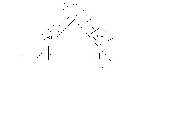

the blocks shown in the figure are connected by flexible, inextensible cords passing over frictionless pulleys. at A, the coefficient fiction is 0.30 while at B, it is 0.40. compute the magnitude and direction of the friction forces and each block.
am i right ? x( please help .. want to learn
Diagram of two blocks on inclined planes joined by a cord over two pulleys: block A, labeled 300 lbs, on a left incline with slope 3 over 4; block B, labeled 200 lbs, on a right incline with slope 4 over 3.
for block A:
teta(A)=tan^-1(o.30)
teta(A)=16.70
N 53.13 W
sine law:
T/sine53.13=300/sin36.87
T=400lbs
for block B:
teta(B)=tan^-1(0.40)
teta(B)=21.80
N 36.87 E
sine law:
T/sin36.87=200/sin53.13
T=150lbs

I can't really see the set-up but can only advise that the usual calculation Friction = uR calculates the maximum possible friction. Perhaps in this case you don't need, and thus won't generate the maximum friction?

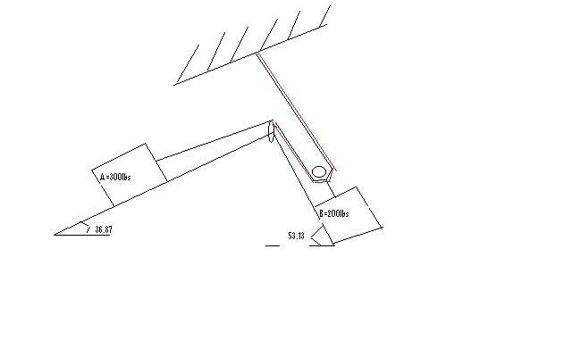

Diagram of two blocks on inclined planes connected by a cord over a pulley hung from a ceiling; block A is 300 lbs on a 36.87 degree incline, block B is 200 lbs on a 53.13 degree incline, and the cord tension is marked in red.
sorry :) this is the figure . my instructor said we must find the tension(that red line) .. what should be the possible formula?

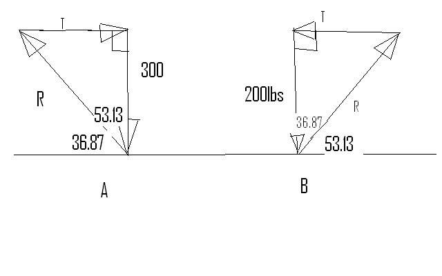

then this the 1st thing i do
Two force diagrams labelled A and B, each showing a triangle of vectors meeting at a point on a horizontal line; labels include T, R, 300, 200lbs, 36.87 and 53.13.
could it be solve by this figure ?
then followed by law of sine
The force supporting each block in position comes in part by friction, and with a rope making up the difference. Friction may be acting up, or down, the slope, according to which way the block is tending to slide.
what would be the possible formula sir? because i can't really understand this topic although i tried my best to solve .. please help thnx
anyway this topic is related to Newtons law of motion
You should draw Free Body Diagrams for both blocks, showing the forces acting. Given the mass of a block and the expression for the net force you should be able to write an expression for the acceleration of each block. These expressions will contain the (as yet) unknown values of the tensions in the two ropes.
Next examine the original figure and determine the relationships between the two accelerations and the two tensions that will be enforced by the pulley setup. You should then have enough information to solve for the tensions.
