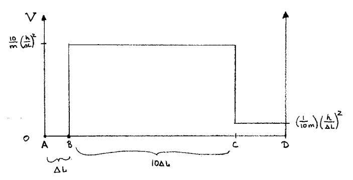

Consider a one-dimensional, non-relativistic particle of mass ##m## which can move in the three regions defined by points ##A##, ##B##, ##C##, and ##D##. The potential from ##A## to ##B## is zero; the potential from ##B## to ##C## is ##\frac{10}{m}\bigg(\frac{h}{\Delta L}\bigg)^{2}##; and the potential from ##C## to ##D## is ##\frac{1}{10m}\bigg(\frac{h}{\Delta L}\bigg)^{2}##. The distance from ##A## to ##B## is ##\Delta L##; the distance from ##B## to ##C## is ##10 \Delta L##; and the distance from ##C## to ##D## is chosen such that the ground state has the same probability between ##A## and ##B## as between ##C## and ##D##.
(a) For the ground state, the physics of this potential is very close to that of two independent infinite square wells. Why? Exploit this fact to estimate the distance from ##C## to ##D##.
(b) Sketch the ground state wave function, indicating the relative signs in the three regions and the rough relative amplitudes (e.g., which is bigger).
(c) Now consider how to obtain the exact solution. Express the ground state wave function in terms of four normalisation constants, plus the energy and the distance from ##C## to ##D##. Write down equations which determine the six unknowns but do not attempt to solve them. However, you should explicitly compute all integrals and derivatives.
Hand-drawn potential energy diagram V against position with points A, B, C, D on the horizontal axis. Zero from A to B, a raised step from B to C labelled 10/m (h/ΔL)^2, a lower step from C to D labelled (1/10m)(h/ΔL)^2, with spans ΔL (A to B) and 10ΔL (B to C) marked.
(a) For states with higher energies than that for the ground state, the system cannot be well approximated by two independent infinite square wells, because with higher energies the tunneling probability across the potential barrier from ##B## to ##C## is increased. This explains why, for excited states, we cannot approximate the physics of this potential by two independent infinite square wells.
But this does not explain why, for the ground state, the approximation is valid. To demonstrate the validity of this approximation, we need to show that the ground state energy is much much less than the energy of the potential barrier. The ground state energy of the infinite square well with barrier thickness ##\Delta L## is ##\frac{h^{2}}{8m(\Delta L)^{2}}##, whereas the height of the potential barrier is ##\frac{10h^{2}}{m(\Delta L)^{2}}##. So, for the ground state, the physics of this potential is very close to that of two independent infinite square wells.
Am I correct so far?
I would like to add some further comments about my solution to part (a).
We don't really need to check if the ground state energy is much much less than the height of the potential barrier for the left well in order to find out if the left well is an infinite square well. And that's because the distance between the wells is much much bigger than the width of the wells so that tunnelling is negligible anyway.
All that we really need to do to show that, for the ground state, the physics of this potential is very close to that of two independent infinite square wells, is to show that the ground state energy is less than the potential barrier of the left well.
