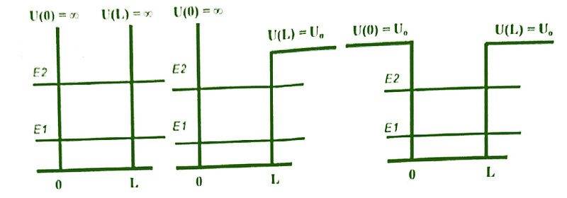

what is is maximum and minimum number of confined states within these potential wells ?
UL>(pi^2)(hbar^2)/8me , the condition for existence of states in the semi infinite well
hi guys
i came across this question about the maximum and minimum number of bound states that can be confined in these potential wells
1- infinite potential well
2- semi infinite potential well (from one side)
3 - finite potential well
i think i have a good idea about the minimum number of states i guess :
1- the infinite has minimum of 1 state it could always have at least one state
2 - the semi infinite if it were very shallow it could have no states so the min is 0
3 - the finite also always have at least 1 states inside no matter how shallow
is that correct.
and I am not sure what is the maximum in each and shouldn't that be dependent on the exact value of V ,
is there is a formula for that that depend on potential ?

I am sorry I should had puten more effort in presenting the problem and my attempt, so here we go :
in the following 1D potential wells as described by the figures :
the question was asking to find the maximum and the minimum number of bound states confined within these systems ?

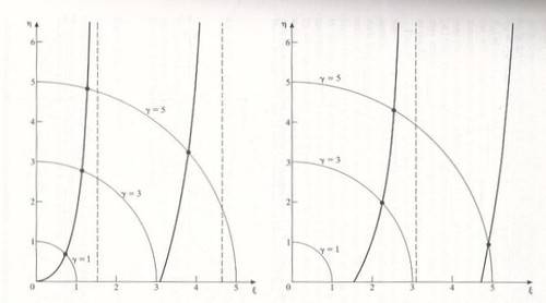

the minimum number can be obtained by looking at the transcendental equation plot for each system, i am taking about the the last two systems , since the infinite well is infinite i guess there is no max and the min is 1 correct me if I am wrong, now for the two systems:
the left one is for the finite well and it shows an intersection point (represents a solution) no mater how shallow the well is . so the minimum is 1.
the right one shows no intersection up till a condition of $$UL>\frac{\pi^{2}\hbar^{2}}{8m}$$
so the min is 0.
not sure how to get the maximum number of states , is it by counting the total intersection points
or there is another approach ?
