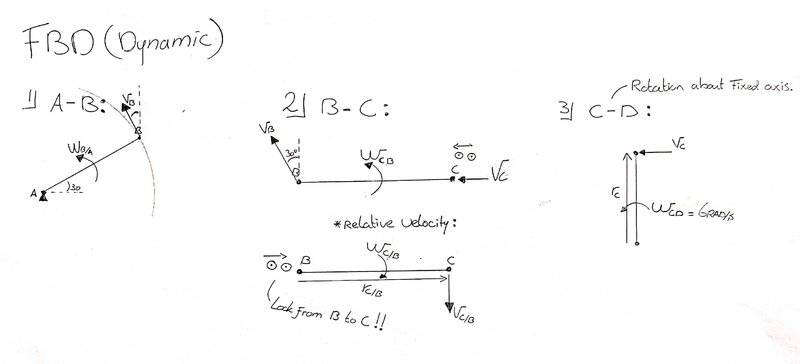

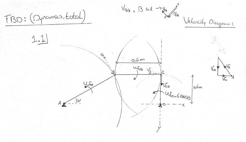

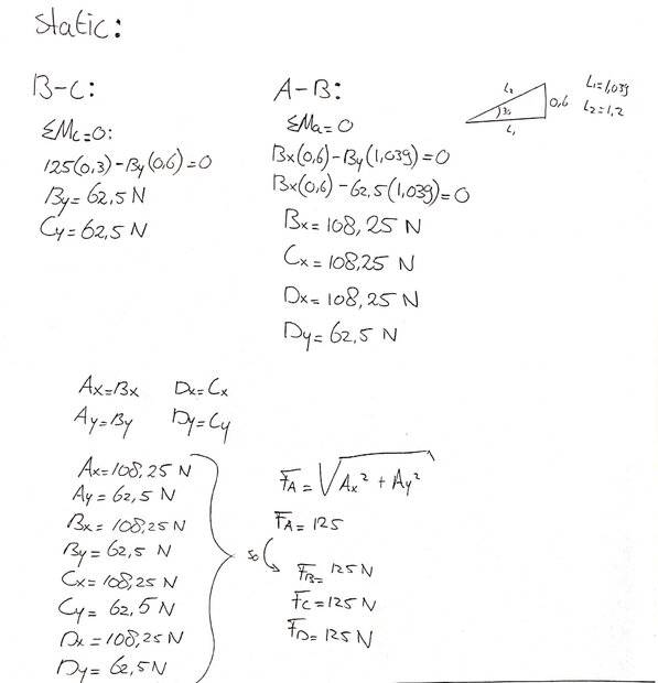

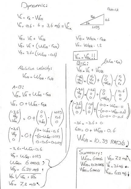

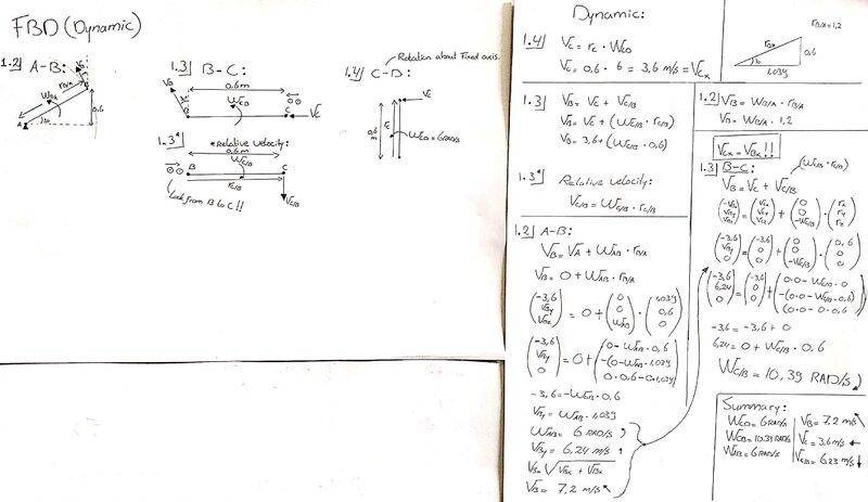

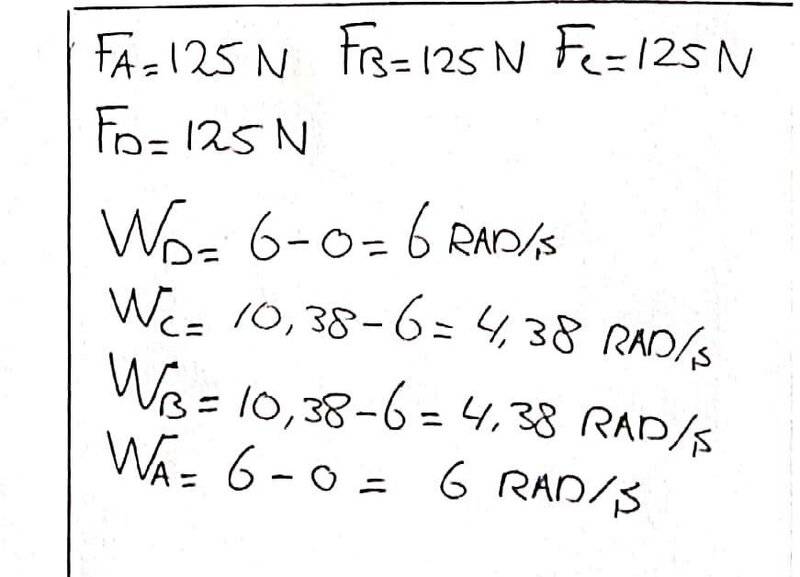

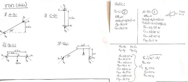

I think I got the results. In summary (pictures are attached):
Forces are:
Fa = 125 N
Fb = 125 N
Fc = 125 N
Fd = 125 N
Angular velocities:
Wd = 6 RAD/s
Wc = 4,38 RAD/s
Wb = 4,38 RAD/s
Wa = 6 RAD/s
Do these results/calculations seems correct? Or did I miss something?
Could you help me on my way to calculate the friction at each point? :)

Numbers on the FBD's please. It's too much switching back and forth without them. The easier you make it for somebody else to follow, the easier it is to check your own work. And those other people are more willing to look into it.

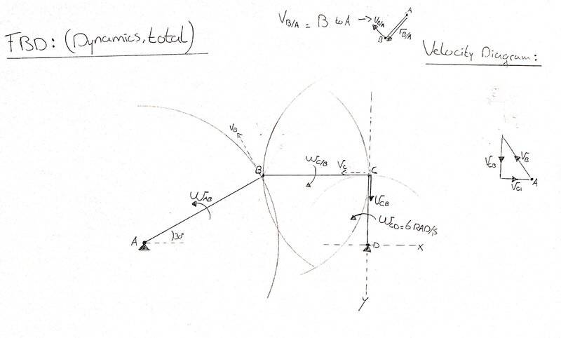

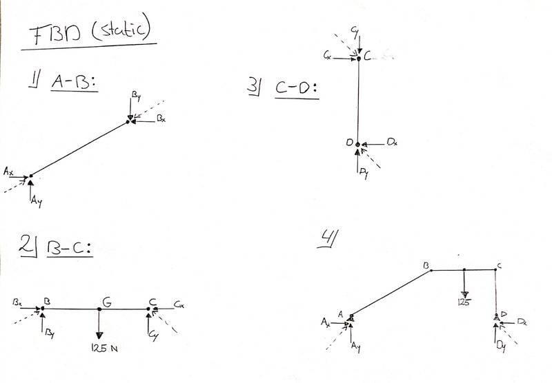

I have modified the sketches and add the numbers on it. Like to hear if it makes sense:smile:
EDIT: I see the pictures aren't sharp if you download them. Strange, because before attached them, they are pretty nice, even when the zoom function is used...

Let's work on the static FBD by itself. Your solution has a horizontal force at C that is not counteracted by a moment at D, so the sum of moments about D is not zero. It needs to be zero.
A good way to double check your work is by taking the sum of moments about A, B, C, D, and G. All of them must sum to zero. You only need the resultant force to calculate bearing loads.

I re-calculated the forces and added a moment around D, without the moment indeed, the force Cx didn't sum to zero.
Afterwards I checked the forces with the FBD and moment around A, G and B. I found a silly mistake here, I missed the force in point B and C. I thought these were internal force and therefore didn't take them into account. Could you explain when those are internal forces and how to recognize them?
The moment in D doesn't play a role in the friction as I understand? This feels strange haha.
See attached the files.
In the case of this linkage, an internal force would be the force inside a link. Link AB, for example, has an internal compressive force (and stress). In a linkage, the forces at each pinned joint are external forces, so each link needs its own FBD.
You are correct, the moment in D does not play a role in calculating friction. It may feel strange at this time, but with more practice at analyzing linkages and trusses, the strangeness will go away.
The next step in calculating friction is a diagram similar to the one in Post #22. It is good practice to have all angular velocity arrows on a single diagram in the same direction - clockwise or counterclockwise. If a particular link is rotating opposite to the arrow, that angular velocity will be negative.

The diagram in Post #25 is well done, but has wrong angular velocities. The diagram in Post #22 is well done, especially the dashed line diagram showing the linkage position after small displacement of the input link. Now compare the rotations of each link to your calculated angular velocity for each link. Focus on the direction of the angular velocity.
Do you mean I should focus on the 'links' rather than the rods? The rotation of each link should be...?:
C = CW
B = CW
D = CCW
A = CCW
