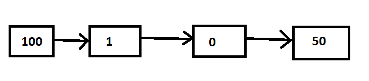

evinda said:
So, do I have to do it like that? (Thinking)
Code:
    Insertion Sort (NODE *A){
       int key, i, j=2;
       while (A.next != NULL){
            key=Nth(A,j).data;
            i=j-1;
            while(i>0 && Nth(A,i).data>key){
                 P = Nth(A, i-1);
                 Q = Nth(A, i);
                 R = Nth(A, i+1);
                 i=i-1;
             P.next = R;
             Q.next = R.next;
             R.next = Q;
             P.data=key;
             A.next=A.next.next;
             j++;
       return A;
Something like that... (Sweating)
What happens if you apply this algorithm to the list in your OP? (Wondering)

At the first iteration, in the inner while loop isn't it P=Nth(A, 0); ? (Thinking)
Which is its value? (Thinking)
  • #33
Currently that is not properly defined.
But we can define it ourselves such that it will return NULL if it does not exist. (Wasntme)

The inner loop that was $O(n^2)$ can be replaced by an $O(1)$ operation (line 5). (Mmm)
Could you explain me further how we could shift a sub sequence with time complexity $O(1)$ ? (Thinking)
  • #46
Suppose we have n=1000 elements, and we have i=5, and j=800.
Furthermore, suppose we have a pointer P to element i, a pointer Q to j-1, and a pointer R to j. (Sweating)
Then we can rehook the elements in the list by:
[m]Q->next = R->next;
R->next = P->next;
P->next = R;[/m]
Regardless of n, this is always 3 operations, so O(1). (Whew)

Actually, we won't need i, j, or n any more.
It's more like this:
Code:
InsertionSort(NODE* A)
  NODE *P, *Q, *R, *S;
  int key;
  if (A == NULL)
    return A;
  Q = A;
  R = Q->next;
  // For each key starting at j = 2
  for (Q = A, R = Q->next; R != NULL; Q = R, R = S) {
    key = R->data;
    S = R->next;
    // Find element at i < j such that A[i] <= key or else set i to 0
    for (P = A; (P != R) && (P->data <= key); P = P->next) {
    // Shift sub sequence from i+1 to j-1 to after key at j
    if (P->data > key) {
      Q->next = R->next;
      R->next = P->next;
      P->next = R;
    } else {
      Q->next = R->next;
      R->next = A;
      A = R;
  return A;
(Thinking)

I tried to apply the algorithm on this list:View attachment 3804
After some steps we have that [m] P->next=R [/m] and [m] P->data>key[/m] where [m] P->data=100[/m] and [m] key=1[/m].
So we execute the if condition and then we have the command [m] R->next=P->next[/m] but [m]P->next=R[/m].
So does [m] R->next [/m] point to [m] R [/m] ? (Thinking)
