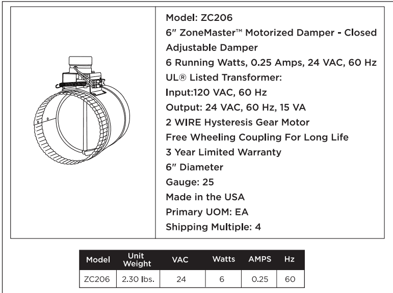

I'm installing 4 motorized dampers in my basement HVAC, the motor on each unit is 24V drawing 6 watts at 0.25 Amps. I will be powering them from one 24V 40VA transformer. One temperature controller, that uses direct output and has a max output capacity of 10A, will be installed between the power supply and the dampers. My question is will this work without burning something up? Should i wire the dampers in parallel to keep the voltage the same across all the motors? And what does direct output mean on the transformer, does it just match input voltage and amps?

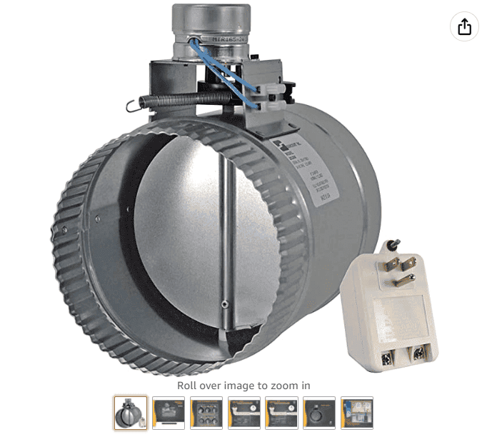

I believe it is referring to the output of the wall plug in transformer that comes with the damper, the damper itself should only use 6 VA, if you use S(VA) = I(A) × V(V) to calculate VA. I attached a pic of the transformer that comes with it below
