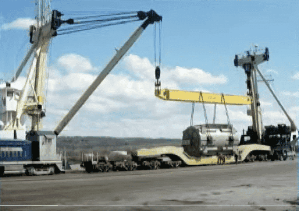

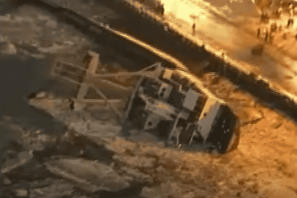

Do they raise the ship like that to make it a steadier platform for the crane?
berkeman said:
Very cool, thanks for sharing. :smile:
I presume so, yes. Here's a case from 10 years ago. In the first picture, you see them lifting cargo using the crane on a docked ship that did not have those 4 feet. 10 seconds later, it was capsized.
Heavy-lift crane on the left lifts a large cylindrical component by a yellow spreader beam, while a wheeled low-loader trailer carrying a similar load sits on a paved area beside it.
Blurry aerial view of a ship listing heavily to one side in water, with a crane structure on its deck and people standing on the quay nearby.
  • Wow
