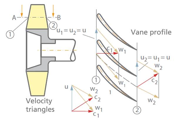

It might be more helpful to view it as a succession of curved convergent or divergent nozzles that accelerate or decelerate the fluid (depending if you want a turbine or a compressor) rather than a succession of airfoils. Look for velocity triangle.
Example of a "curved divergent nozzle" where velocity goes from ##W_1## to ##W_2##:

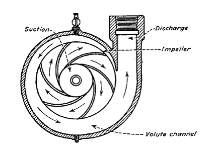

The concept of a "curved nozzle" might be clearer on a centrifugal compressor (or turbine when rotating in reversed):
