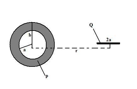

An insulating spherical shell of the external radius b and the internal radius a is charged uniformly with volume charge density p. What force F does it produce on a uniformly charged thin rod, as shown in figure2? Rod's total charge is Q and length 2a. The rod is arranged radially from the center of the sphere, the distance from the rod's center to the center of the spherical system is r.

The goal here is to find the net force acting upon the rod. It's obvious the rod lies parallel with the radial electric field produced by the sphere, so the field the rod produces will not affect the field from the sphere (and thereby the force acting upon it). Though the fields may interact outside the radial line of the rod, but I'm not sure if that will determine the force (hunch says yes...).
The force at any point along the rod will differ dependent upon its distance from the outer surface of the sphere where the charge is maintained.
Any advice in regards to this problem?
Set up an expression for the force on an element of the rod's length and integrate. First you'll need to figure out the field from the charged spherical shell as a function of distance from its center.
So first the electric field of a hollow sphere is E = (q/r[tex]^{2}[/tex])Ke where q is the charge of the sphere. I'm guessing I need to use the surface charge density to obtain q?
The equation I'm finding for the force is F = E(q) where q is a point charge. I have Q which is the total charge for the rod, so dQ will be the infinitesimal charge at any point along its length. The integral will be from r-a to r+a..
I'm given the volume charge density (Charge / unit[tex]^{3}[/tex]), so I use a and b to get the volume and multiply this by [tex]\sigma[/tex] to get the total charge on the sphere?

Exactly. Then use Gauss's law to get the electric field at any point outside the sphere.
The use that field expression to find the force on an element of the rod's charge, expressed in terms of its length. The element of charge should look like [itex]dQ = \lambda dx[/itex], where [itex]\lambda[/itex] is the charge per unit length.
Putting all that rambling nonsense together, I get F = E(dQ), so I will end up integrating: Ke[tex]\int[/tex][tex]^{r+a}_{r-a}[/tex](q/r[tex]^{2}[/tex])dQ
Is this correct...? It's been a long weekend.
Okay great, so I am getting closer. :) Let me work this out...
Yes, you're almost there.
With my shipshod integration I managed to find F = Ke*q*Q[[tex]\frac{1}{r - a}[/tex] - [tex]\frac{1}{r + a}[/tex]]. That's got to be close at least, though I'm not sure about Q.

Since that's the force between two point charges, I'd have to say no. But since the charge distribution of the insulating shell is spherically symmetric, you can treat its field as equivalent to a point charge at its center.
And if I know rho = Q / V and shouldn't I be using V = 4pi(b-a)^2 since there is no charge on the inside?
Yes, use the volume of the shell to find the total charge of the shell. Edit: But that volume should be 4/3 pi (b^3 - a^3). (Thanks to V2Viper25 for bringing that to my attention.)
Why are the limits on the integral from r-a to r+a? And why do I need the charge density of the rod? If the formula is just charges over r squared and I am given Q isn't that sufficient?
While you can treat the shell as a point charge, you can't treat the rod as one. Find the force on each element of charge on the rod ([itex]\lambda dr[/itex]) and integrate to find the net force.

It's true that if r >> a, you could treat them both as point charges. But in that case the problem isn't very interesting. They want you to integrate.
