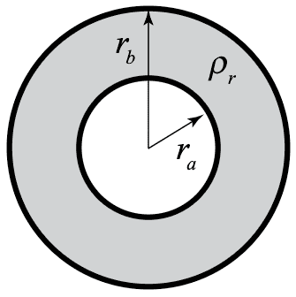

A resistor consists of two concentric conducting spherical shells with the inner shell having radius ##r_a## and the outer shell having radius ##r_b##.
The space between the two shells is filled with a material of resistivity ##\rho##.
What is the resistance of this resistor?
##V=iR##
Cross-section diagram of two concentric spherical shells: a white inner sphere of radius r_a and a grey region between it and the outer shell of radius r_b, labelled with resistivity rho_r.

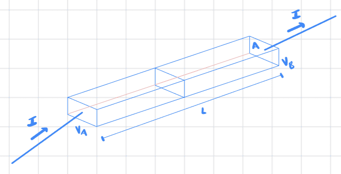

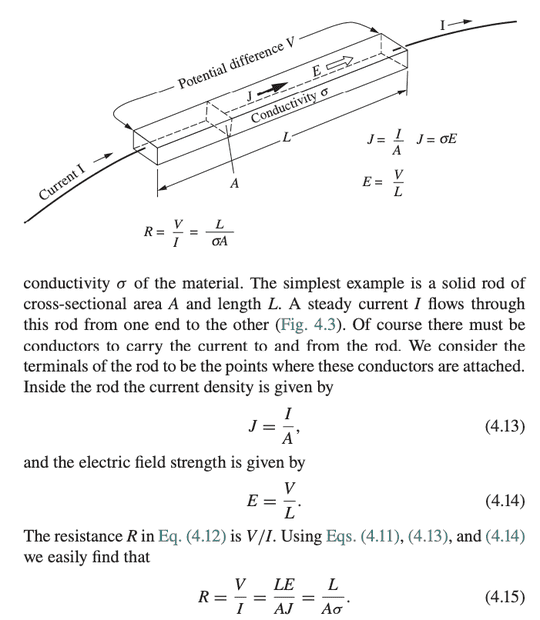

This assumption of steady current is used to find an expression for resistance on a conducting rod with well-defined geometric shape such as in the figure below
Isometric sketch of a rectangular conducting rod in blue, with a red centre line along its length, labelled L along its length, with end faces marked VA and VB and a point A at the far end; current arrows labelled I enter and leave at each end.
For such a conducting rod, we find that ##R=\frac{L}{\sigma A}##.
Does any of this apply to the situation of the two spherical shells with the resistor in between?

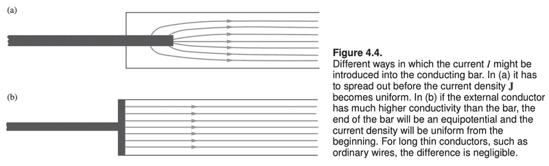

Regarding "steady currents", Purcell says that
We speak of a steady or stationary current system when the current density vector ##\vec{J}## remains constant in time everywhere. Steady currents have to obey the law of charge conservation.
The simplest example of a conductor is a solid rod.
We assume that
- The conductors bringing charge in and out of the rod are such that there are no "end effects". That is, the current density is uniform right from the start to the end of the rod. This assumption can be relaxed if the length of the rod is very long compared to its width.
Two diagrams of a conducting bar with current lines entering from the left: (a) lines spread out in a box before becoming uniform; (b) lines are uniform from the bar's end.
- The current density is uniform over a cross section of the rod. If this were not so, then ##\vec{E}## would not be path independent.

It doesn't seem to be backwards. Consider the derivation of this formula from Purcell's Electricity and Magnetism
Diagram of a rod-shaped conductor carrying current I from left to right, with length L, cross-section A, conductivity sigma, potential difference V across it, and equations J = I/A, J = sigma E, E = V/L, and R = V/I = L/(sigma A).

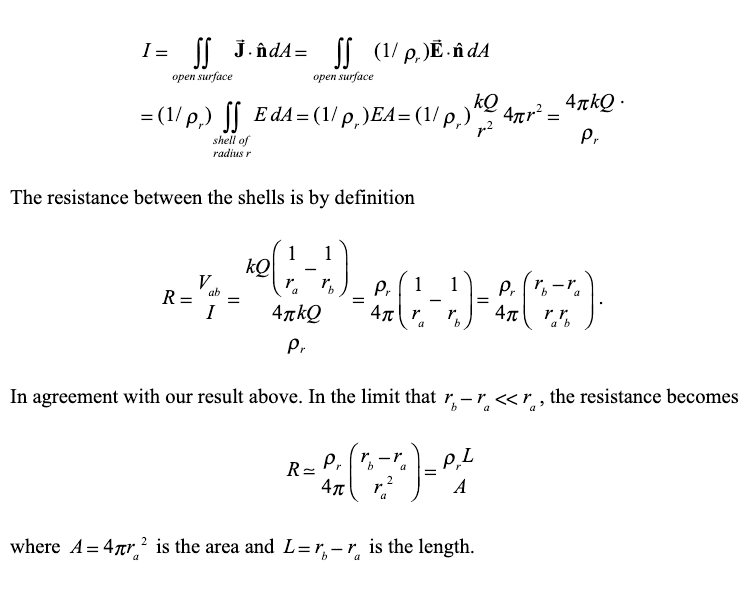

Here is a weird solution (the formatting is messed up but it is still readable).
This solution seems to assume the electric field is that of a point charge located at the center of the spherical configuration.
Handwritten-style derivation of current I through a spherical shell and the resistance R between two concentric shells, ending with R approximately equal to rho_r L over A where A = 4 pi r_a squared and L = r_b minus r_a.
