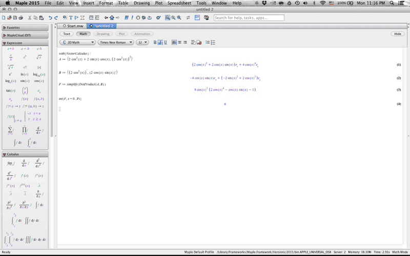

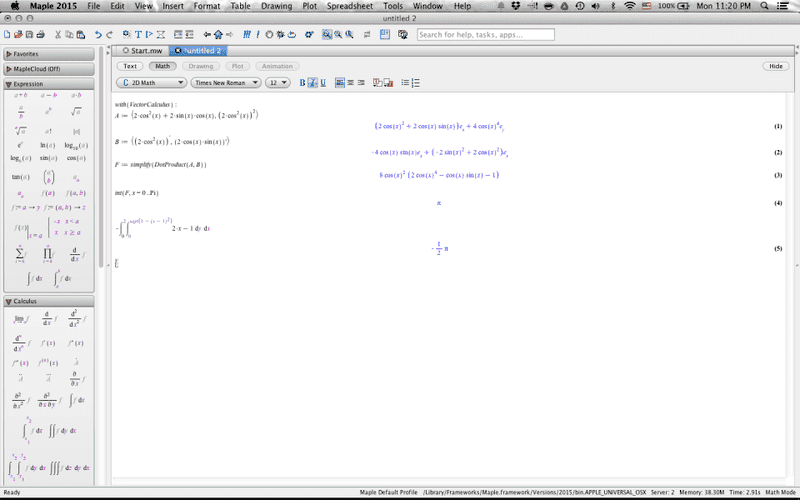

Also, I evaluated it using the vector definition of a line integral using Maple, and got Pi as the answer using the parameters and -Pi/2 as the answer without...
When I use Maple 11 to evaluate the integral ##J = \int_0^2 (x + y + x^2 y') \, dx## (with ##y = \sqrt{2x - x^2}##) I get ##J = 2 - \pi/2##, which is the book's answer. I did not bother to use the "VectorCalculus" package, because just doing a direct evaluation seemed much faster and easier.
The images you posted are too small and too blurry to make out, so I am not able to see any of the details of your computations. I would suggest copying and pasting individual lines, rather than attaching an image. For example, here is the indefinite integral (after putting y = sqrt(2*x - x^2) and dy = diff(y,x)):
> int(x+y+x^2*dy, x); lprint(%);
(1/2)*x^2-(1/4)*(2-2*x)*(2*x-x^2)^(1/2)-(1/2)*arcsin(-1+x)+(1/3)*x^2*(2*x-x^2)^(1/2)+(1/3)*x*(2*x-x^2)^(1/2)+(2*x-x^2)^(1/2)
This is copied and pasted directly from the Maple 11 worksheet
Thank you both for your responses. I see now that I was dropping the x^2 and keeping the y'(X) term. *sigh*
