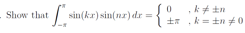

Here is the question given:
SO i used the product to sum angle formula:
sin u sin v = 1/2[cos(u-v) - cos (u + v)]
so I get
from ∏ to -∏
1/2 ∫cos(k-n)x dx - ∫cos(k+n)x dx
= 1/2 [1/k-n (sin (k-n)∏ - sin(k-n)-∏) -1/k+n(sin(k+n)∏ - sin(k+n)-∏)]
so when k isn't equal to ±n, i think the second term becomes 0, but the first term doesn't have to be 0 as well (for the first condition).
What is [itex]\sin(n\pi)[/itex] if [itex]n\in \mathbb{Z}[/itex]?
Also note that your method does not work if n=k. Indeed, you seem to have a term [itex]\frac{1}{n-k}[/itex] there. But if n=k, then you will divide by zero. So if n=k, then you'll need to do something different.

sin(mπ) = 0 for all integers, m. So when k≠n, all those terms are zero.
When k=n, the last term is zero. The first term must be evaluated as a limit n → k .

If k=n, then
[tex]\int_{-\pi}^\pi \cos(n-k)x dx=\int_{-\pi}^\pi \cos(0)dx=\int_{-\pi}^\pi dx[/tex]
If n=k, the integrand becomes sin2(kx).

I see what you did but k+n doesn't necessarily have to be an integer does it? What if k+n= 0.5, it doesn't make it 0.
I think the question implies that both n and k are integers. If n and k are not integers, then the result is not true.
