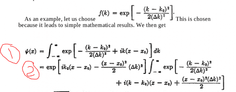

Two equations from a textbook page: psi(x) equals the integral over k of exp[-(k - k0)^2/(2(Delta k)^2) + ik(x - x0)] dk, circled as 1, followed by the rewritten form exp[ik0(x - x0) - (x - x0)^2(Delta k)^2/2] times the integral of exp[-(k - k0)^2/(2(Delta k)^2) + i(k - k0)(x - x0) + (x - x0)^2(Delta k)^2/2], circled as 2.
Hi,
what kind if integration used on equation 1 so it turned into equation 2? this does not look like integration by parts. and where (x-x0) appeared from instead of (k-k0) ?
thanks for your help.
No integration was done. For instance, for the imaginary term, you multiply by the right-hand side by ##\exp[i k_0(x-x_0)] \exp[-i k_0(x-x_0)]##, and move the second exponential inside the integral sign.
No integration has been done yet. It's the old mathematical trick of multiplying and dividing by the same thing.
Outside the integral is a factor of
$$\exp\left[-\frac{(x-x_0)^2}2(\Delta k)^2\right]$$
and inside the integral is a factor of the reciprocal
$$\exp\left[\frac{(x-x_0)^2}2(\Delta k)^2\right]$$
These cancel each other out.
They can be freely moved through the integral sign because they do not involve the integration variable ##k##.

But this image is from David Bohm's Quantum Theory.
