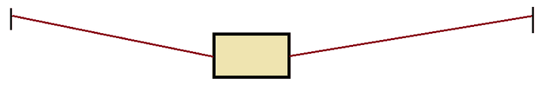

It might help to consider the attached figure where a block is supported by two ropes which are almost horizontal. In this case, you can show that the force which the block exerts on each rope is much greater than the weight of the block.
It's important to keep in mind that the weight of the block is just the force of gravity acting on the block. The weight of the block only acts on the block, not on any other object. If an external object exerts a force on the block, then the block will exert the same magnitude of force on the external object (no matter how large). In the case of the ropes, the ropes must pull hard on the block to provide enough vertical component of force on the block to cancel the weight acting on the block. If a rope pulls hard on the block, then the block pulls back hard on the rope.

Okay wow thanks for helping so much! I'm starting to understand a bit more, but still when i think of like a human pyramid with one person on top and two on the bottom, each person doesn't get the full weight of the person above them, they share the load. How are these situations different?
The human pyramid is essentially the same problem. Suppose the top person's legs are spread to form a right angle and assume that the top person's feet exert forces on the shoulders of the bottom people in the direction of the legs of the top person (i.e., at 45o to the horizontal.) Then each foot of the top person will exert a force on a shoulder of a bottom person that is greater than half the weight of the the top person.
