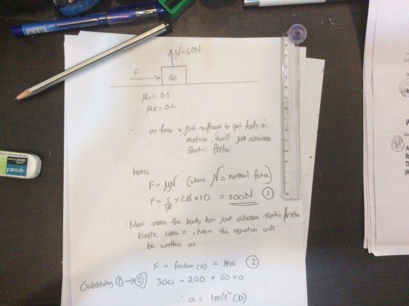

Great ! I think I got the answer (hopefully) the working is in the attachment
I'm sorry for not using units,I'll make sure to use them henceforth.im extremely unfamiliar with the keyboard layout !
Please stop attaching pictures instead of typing your work. It violates forum policy.
Also, if you used symbolic expressions all the way rather than inserting numbers in every step, you would realize which piece of information in the problem was superfluous.

mass is superfluous isn't it ?

Yes. All of the forces are proportional to the mass, which means it cancels out with the ##m## in Newton's second law.
