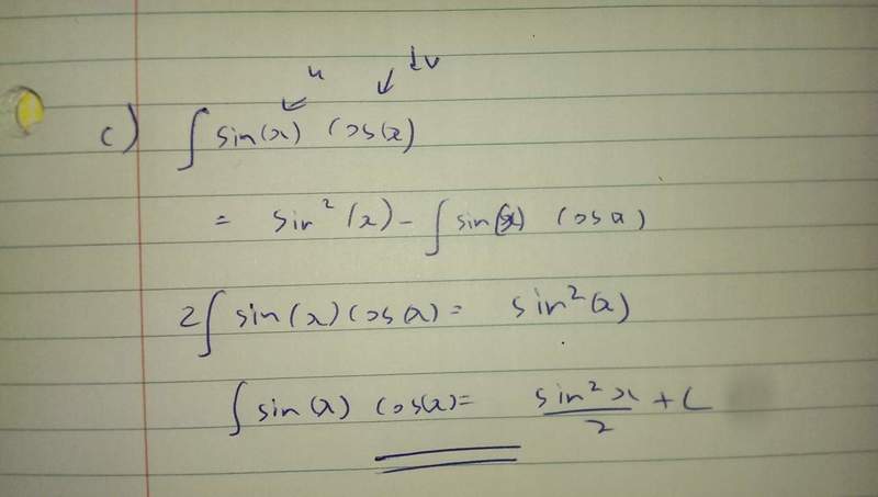

I know its easier to use the substitution method, by I'm trying to see how it'll work for integration by parts. I follow the LIATE method for integration by parts.
Handwritten integration by parts working for the integral of sin(x)cos(x), with u and dv arrows marked, leading to sin^2(x)/2 + C.

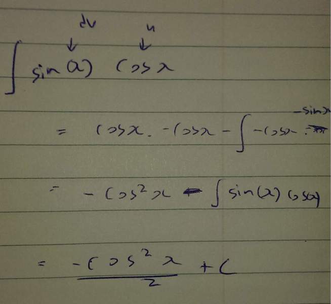

Now if I take u=cos(x) and dv = sin(x), the answer changes.
Handwritten integration by parts of sin(x)cos(x): dv marks sin(x), u marks cos(x), leading to -cos^2(x) minus integral of sin(x)cos(x), then -cos^2(x)/2 + C.
Can you please explain this to me? Which is the 'right' answer?
  • Handwritten integration by parts working for the integral of sin(x)cos(x): u = sin(x) and dv = cos(x) dx, giving sin^2(x) minus the integral of sin(x)cos(x), then 2 times the integral equals sin^2(x), and the result is sin^2(x)/2 + C.
  • Handwritten integration by parts of sin(x)cos(x): dv marks sin(x), u marks cos(x), leading to -cos^2(x) minus integral of sin(x)cos(x), then -cos^2(x)/2 + C.
Rather than answer your question directly, let me provide another example of the same phenomenon that might make it easier to identify why both answers are correct.
If you compute ##\int (x+1)\ dx## using the sum rule for antiderivatives and the "reverse power rule", you get $$\int x+1\ dx=\frac{1}{2}x^2+x+C.$$ If instead you use a ##u##-sub, with ##u=x+1##, you get $$\int (x+1)\ dx=\int u\ du=\frac{1}{2}u^2+C=\frac{1}{2}(x+1)^2+C.$$
Now the exact same thing is happening in your example as is happening here; you have two different-looking answers that are both correct. How can that be?
And closer to home, let's do ##\int \sin(x) \cos(x) dx## a third way, using the trig substitution ##\sin(2x)=2\sin(x) \cos(x)##. Thus ##\int \sin(x) \cos(x) dx = \int \frac {\sin(2x)}2 dx = -\frac {\cos(2x)} 4 + C##.
To quote gopher_p,
gopher_p said:
How can that be?
dear friend , all these answers are different only by a constant, so they are the same answers.
