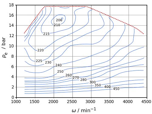

About a car internal combustion engine.
Lets suppose the engine torque is maximum at 3500 RPMs when the engine gets also its maximum load, let's say, a 90%. This kind of data is usually shown at WOT.
My question is: if the throttle is not wide open, but half open, allowing the cylinders to be loaded with 45% (half of the maximum load), is the engine torque also reduced to the 50%? and so would the output power?. I mean, at the same RPMs, is torque proportional to the engine load?
Or, Does the engine efficiency change when partially loaded and then, the torque is something difficult to figure out? and so, would I need my engine BSFC map to solve this question?.

For me, your question does not make any sense as "percentage load" is by definition "percentage of maximum available torque output". So load and torque are the same thing, measured differently (or in different "units" if you will).
What I think you refer to is the "percentage load" that is estimated from intake manifold air pressure by EFI systems. In that case, I would say that it is just that, an estimation. Computer tables must be determined by comparing those inputs (intake pressure, temperature, air flow, etc) to actual torque data from dyno tests such that proper injection time and ignition timing can be chosen.
If you refer to the angle of the throttle plate, it is not directly related to the manifold pressure so even less to the torque output of the engine.

The point is that I am trying to plot a BSFC map of my small car engine according with the fuel consumption numbers I am empirically figuring out and I see that the sweet spot is drifted to the higher RPMs range (around 4500 RPM).
Most of BSFC maps (in a torque-RPM graph) I get in internet technnical pages have that sweet spot (highest efficiency) evolving a point around 70% of engine load and 40% of maximum RPMs (about 2500 RPMs).
My engine is an 2-cylinder boxer type with a maximum RPM of 6000. My question is: will this 2-cylinder engine have its sweet spot drifted to a higher rpms with respect to a normal 4-cylinder engine?. Is there any explanation that may argue this?.
This small car has a 28 HP at 5500 RPMs when in 4th gear reaches its maximum speed (110 Km/hr). Its torque peak is at 3500 RPMs (4.1 mkg).
What I want to know is, if because the fact of having 2 vice 4 cylinders, the BSFC map is drifted to a higher RPMs.
Thanks in advance.
The number of cylinders have no real effect on fuel consumption (everything else being the same).
BSFC depends mostly on valve events, fuel enrichment and ignition timing. For example, most BSFC maps found on the net are for «everyday» cars, so they are tuned for fuel efficiency. If your engine is tuned for maximum power, it will probably have its sweet spot at a higher rpm.
Nonetheless, I would guess that this spot cannot be higher than the rpm for maximum torque as past this point, usually efficiency starts dropping. So I found suspicious that you have your best BSFC at 4500 rpm and peak torque at 3500 rpm. Maybe there is an error in your measurements.
