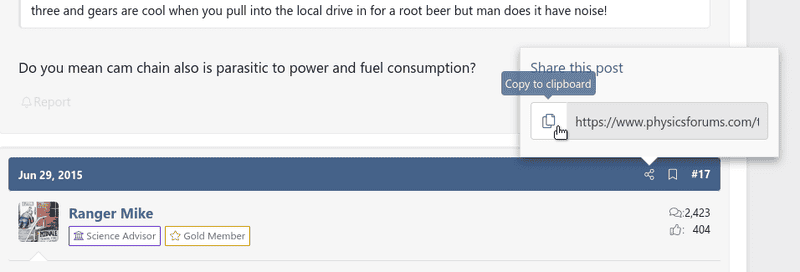

FYI: you can insert a direct link to any post on PF. The posts you are referring to are:
https://www.physicsforums.com/threa...-chain-versus-gear-driven.710081/post-5153741
https://www.physicsforums.com/threa...-chain-versus-gear-driven.710081/post-5154901
You can find these URLs by selecting the share icon
White share icon with three connected circles on a blue background.
on these posts and then clicking on the copy icon
like so:
Screenshot of a forum post's share popup with a Copy to clipboard tooltip over a copy icon next to a physicsforums.com URL, with the post number #17 and the post date Jun 29, 2015 visible.
Then paste the URL in any text you type, like this new post I just wrote for example.
You can also link to the thread entirely by removing the post ID at the end of any of the previous URLs above, like so:
