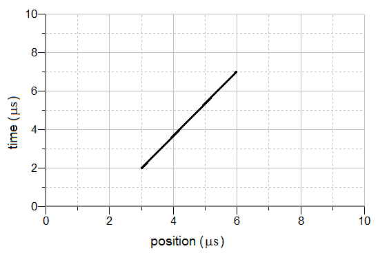

It's hard to demonstrate this graphically because a graph is has be drawn on a piece of paper or a computer screen, and both of those surfaces obey the Cartesian coordinate rule ##ds^2=dx^2+dt^2## (if we call the vertical axis the "t axis" instead of the "y axis") from the Pythagorean theorem. There's a plus sign in there where we need a minus sign, which just goes to show that space-time doesn't work like ordinary space.
It's easy enough to demonstrate it with a bit of algebra though. Put one end of your interval at the origin ##(x=0, t=0)## and the other end at the event ##(x=a, t=b)## so ##\Delta{x}=a-0=a##, ##\Delta{t}=t-0=t##, and ##\Delta{s}^2=\Delta{t}^2-\Delta{x}^2=b^2-a^2##. Use the Lorentz transforms to calculate the coordinates of the point ##(x=a, t=b)## in the moving frame and use these to calculate ##\Delta{s}^2## in that frame. When you do, all the ##v## and ##c## and ##\gamma## stuff will miraculously cancel out and you'll be left with the same ##b^2-a^2##.

Can this be represented graphically as well on the x/y cartesian coordinates,
That's not so easy to do. Any graphical representation is going to have to be drawn on a sheet of paper or the screen of a computer, and both of those surfaces obey the Euclidean geometry instead of the Minkowski geometry. You can draw an x-axis on a sheet of paper, and you can relabel the y-axis the t-axis, but the distance between two points on the sheet of paper is going to be the Pythagorean ##\Delta{s}^2=\Delta{t}^2+\Delta{x}^2## instead of the Minkowski ##\Delta{s}^2=\Delta{t}^2-\Delta{x}^2##.
I realize this, but even if if the surface used obeys to the Euclidean geometry,still won't it give at least an approximate visual appreciation of how ct shifts on the Y axis in function of the spatial movement of the object/events along the X axis? ..
In other words.suppose that we have 3 worldlines to represent on the Cartesian coordinates framework : WL a, ( no spatial motion) is vertical, parallel to the ct axis, WL b: slopes to the right along X , WL c: sloping further down .as spatial movement along X increases. For any given X values, how do we represent the corresponding Y(ct) values on the Y axis? I'd say it is more a question of methodology than of proving the validitity of the invariant formula, because I already understood that from the algebraic formula.
May be somebody can take it from here.
I guess I don't understand your confusion here. If the object is traveling from the origin at 0.6 c then the worldline goes from the origin in a straight line through X=0.6 and Y=1.0. Is that somehow unclear in any way?
