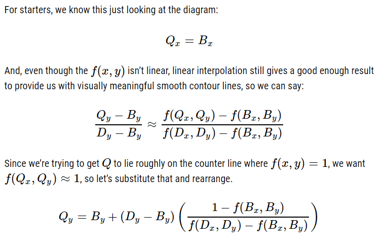

In the "Linear Interpolation" section This article discusses how to interpolate the values when the lines are oblique.
For example, for Case#2 it has the following calculation:

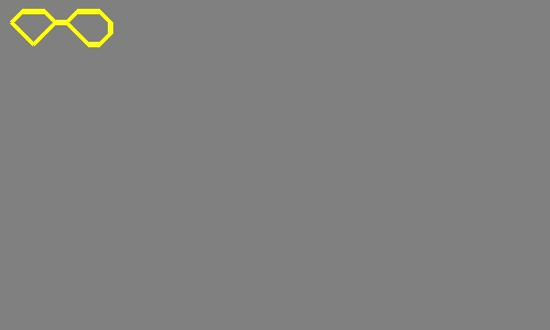

The following main() function gives the correct output:
[CODE lang="python" title="main()"]def main():
example = np.array([
[0, 0, 0, 0, 0, 0, 0, 0, 0, 0, 0],
[0, 0, 1, 1, 1, 0, 0, 1, 1, 1, 0],
[0, 1, 0, 0, 0, 1, 1, 0, 0, 0, 1],
[0, 0, 1, 0, 1, 0, 0, 1, 0, 0, 1],
[0, 0, 0, 1, 0, 0, 0, 0, 1, 1, 0]
x = [0, 10, 20, 30, 40, 50, 60, 70, 80, 90, 100];
y = [0, 10, 20, 30, 40];
collection = marching_square(x, y, example, 1);
for ln in collection:
for toup in ln:
draw.line(toup, fill=(255, 255, 0), width=5)
im.save('output.jpg', quality=95)[/CODE]

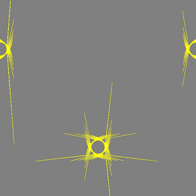

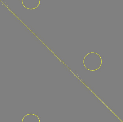

The following is not giving the correct output:
[CODE lang="python" title="main2()"]def main2():
x = [i for i in range(628)];
y = [i for i in range(628)];
example_l = [[0 for i in range(628)] for j in range(628)]
f = open("o.txt","w")
for i in range(len(example_l)):
for j in range(len(example_l[0])):
example_l[j] = math.sin(i / 100.0)*math.cos(j / 100.0)
print(i,j,example_l[j], file=f)
example = np.array(example_l)
f.close()
print("filled")
collection = marching_square(x, y, example, 0.9);
print("done")
I am = Image.new('RGB', (628, 628), (128, 128, 128))
draw = ImageDraw.Draw(im)
for toup in ln:
draw.line(toup, fill=(255, 255, 0), width=1)
The expected output should be probably as follows:
I think the interpolation is not working correctly.

This is 150 lines of code, without comments, with unnecessary empty lines that make scrolling through the code more annoying. I suggest you do more debugging yourself first. Disable more cases to identify the cases that give wrong lines. Then look at individual lines in the problematic cases. Most likely the calculated end points are wrong. This could be an incorrect formula, rounding errors, or python treating things as integer where you expect floats.
Your expectation has x and y swapped relative to the output, but that's probably a minor concern.
