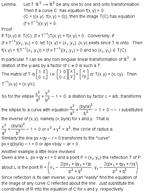

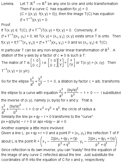

Hi Pranav,
You asked about dilation along an axis. I've found the following to be very useful.
  • Typeset proof of a lemma about one-to-one, onto linear maps of R^2 and images of curves, with worked examples of a y-axis dilation applied to an ellipse and a reflection of a line.
Hi johng! :)
Thank you for taking the time to explain the dilation of axis but I fear I cannot understand that as I am not well versed with the notation you have used. I will see if I can find something on the internet or books. Thank you once again.
