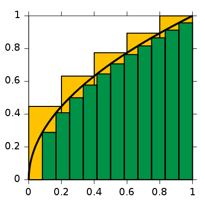

One definition of the integral is the sum of very small rectangles having width (dx) and height f(x). Using the rectangle definition, the area is the most intuitive understanding of a height times the width.
## \int_a^b f(x) dx = \lim_{dx \to 0} \sum_{j=0}^N f(x_j) * dx, \, N = (b-a)/dx, \, x_j = a + j*dx ##
Of course there are other definitions of integrals, but this is a pretty commonly used one.

Just about every calculus textbook leads up to the definite integral showing a picture similar to the following.
(See https://en.wikipedia.org/wiki/Integral)
The textbooks usually define the Riemann integral as the limit of a sum of area elements. Haven't you ever seen something like this?
