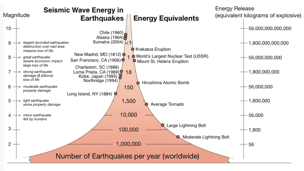

@davenn, My statement may indeed be wrong, but IMHO your argument does not logically contradict what I said. I am not sure that there is enough strength in the plates to realistically hold together until an M 10 occurs, but I am not an expert. In fact, there have been a great many smaller events already without an M10 and there may be a great many more before one occurs. So their cumulative energy released might eventually be enough to equal an M 10.
That being said, I see what I think is your point that the energy required might make it so rare that we just have not seen one yet.
Yes it does. There's no reasonable or scientific grounding in stating that a lot of small quakes will stop the occurrence of a much larger event. As I hinted at in my previous post responding to DaveC,
if lots of small quakes released enough energy to prevent larger quakes then we wouldn't even see the larger quakes that we do see happen.
It's pretty much agreed in the seismological world that there isn't a plate boundary on Earth large enough to accumulate the stress needed to generate a M 10 event
We don't get those great numbers of smaller events that you refer to, it just doesn't happen.
A M4 is 10 x greater than a M3
A M5 is 100 x greater than a M3
A M6 is 1,000 x greater than a M3
A M7 is 10,000 x greater than a M3
A M8 is 100,000 x greater than a M3 etc
you can do that for any magnitude quake
And the energy released is 32 x greater with each step
Even a bunch of M 6 events isn't going to stop a M8 from occurring in a specific
large subduction region. Wayyyyyyy up the page I listed the various large subduction regions
around the world and the numbers of known large events on them. Maybe you didn't read the
whole thread ? :smile:
Think on this for a minute
A M 10.0 is 10 times greater than a M 9.0
32 times more energy released than a M9.0 !
Look at the top of that graphic that @DaveC426913 provided a couple of posts ago. If you were willing to do the math (I'm not/ nor able to) I wouldn't be surprised if it was more energy released that all the nukes in the world detonated at once and many times over
Dave
